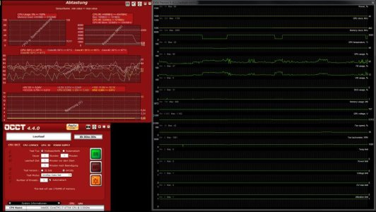

I installed a new 780 GHz last week and I am getting extremely poor performance compared to my 670.
I tried CoD:BO2, CSS and Crysis 3.
The fps completely drop below 10fps for several seconds every 15-20 seconds.
Below is a screenshot from playing some CoD on lowest settings in 1080p. Every time the GPU load spikes, the fps crash down.
I also Have a new PSU, RM850, but I don't have any trouble with other parts.
I haven't had any bluescreens since the change.
What do you guys think?

I think you need to give more info... it's hard to tell what it could be with the info given (or lack of)
Well, I am not sure what additional info you are looking for.
System:
4770K @4.5GHz
H105
Sabertooth Z87
32Gb Corsair Vengeance LP
Windows 7 Pro
OS Drive OCZ Agility 3
Other Drives: 256Gb 840, 2Tb Barracuda, 2x500Gb Caviar
RM850 (used to be HX1000)
Gigabyte GTX 780 GHZ (used to be 670 Windforce 3x)
I have noticed some performance issues in the last few months were explorer or programs like skype or firefox take unusually long to respond. I'll try and do a clean Windows 7 installation this week, maybe that will fix the problem with the GPU.
Like I said before though, I didn't have any problems with the HX1000/670 setup.

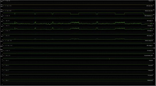

Here Is another Screenshot. This time I was playing CS:S at max settings. The drop frequency seems to decrease as the I increase the graphics in all games o.O
I took the screenshot right after a big frame drop (220fps>3fps) for about 5 seconds.
Sorry about the two attachements. I wanted to test if I couldn't upload a better picture, but it seems no pictures above 100Kb are allowed (the original is 1.3Mb). No idea how to delete attachments either.
If you need anything else please let me know :)

yes all drivers are installed using the in-wizard "clean installation" option and up to date. 337.50 Geforce Experience and Version 7.7.740 Control Panel
It is def. the CPU. I just ran OCCT and Valley at the same time, and I could hardly run it.
4.5GHz 65 degrees
Even at 4 GHz its not much better.
