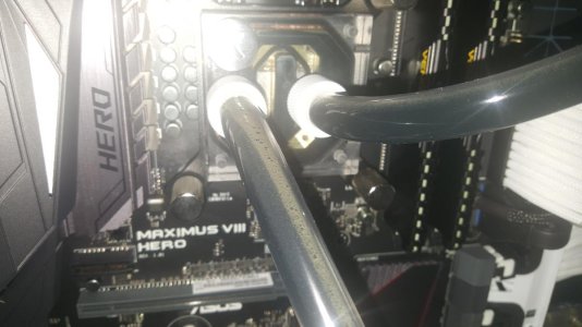

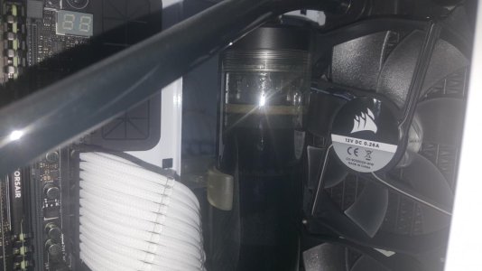

Is this normal when filling the loop with pastel coolant for the first time?
I flushed the rads exactly as stated
Bubbles are normal as advised in other thread you need to tip rads ect ect to get them out. It takes time to do.
Cheers it's not the bubbles that was worrying my it was the foamy look to them which I have realised now is something unique to pastel coolants
