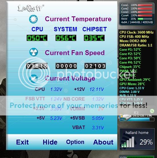

as the title says can i go any further or should i stay with 3.6.the pic below is after running p95 for 6 hours.the VID for my chip is 1.2125
anyone got any tips on how to get further??

you can get more out of it.. max load temp i would be comfy with is 65C you are well below that.
id say raise the FSB and give it a smidge more on the voltage and you should be able to hit 3.8 maybe 4 depending on cooling.
remember not to go past 1.5 on the vcore.. i mean you could.. but thats a lot of stress on the cpu.

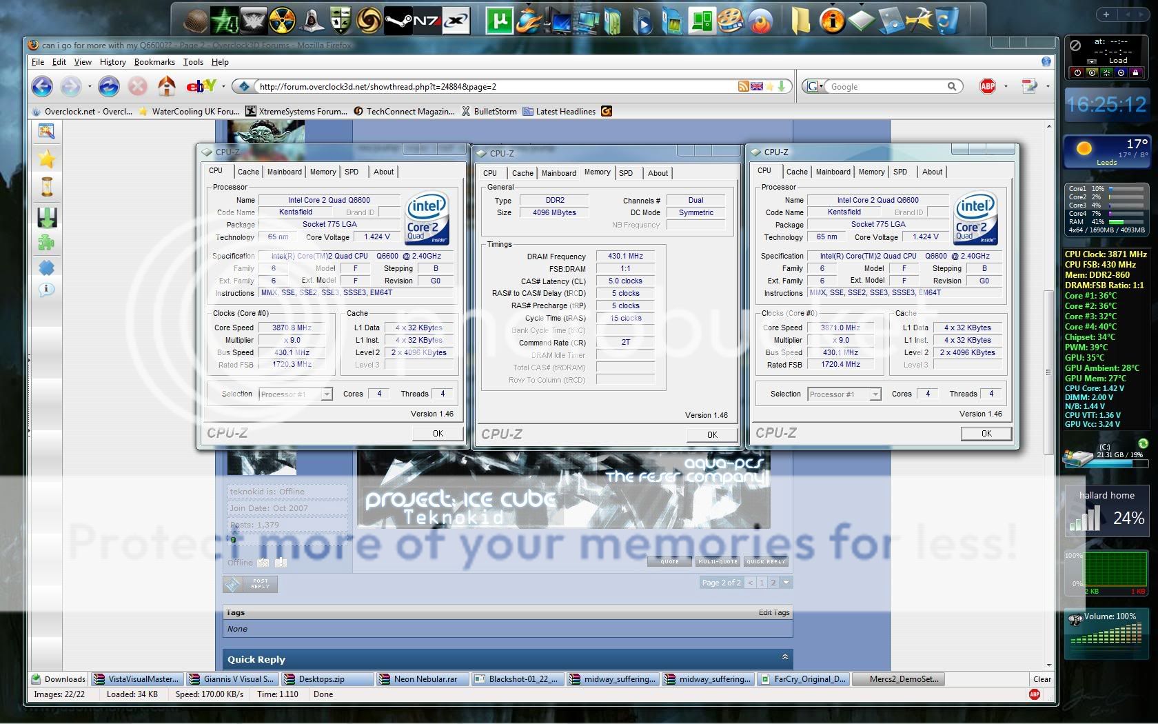

fsb at 423= 3810mhz
temps so far are cores 61-62-63-61
n/b 39
pwm 72----need to get some more flowing accross that i think

well it passed 6 hours of prime95 at those settings,so I am now gonna dial down and see what the lowest vcore is that will run 3.8,after that its time to see how far it will go.

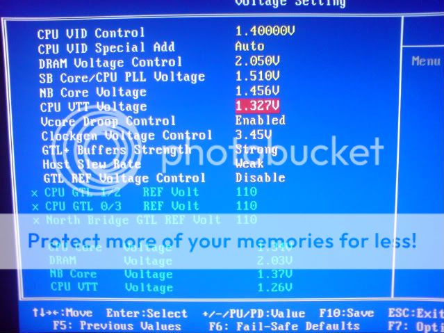

this is how it stands at the moment,have managed to get a WHOLE 60mhz further and then prime fails on core 2 after 5 mins.have I reached the point where I need to start messing around with the GTL voltages,as mine are still on the default settings
