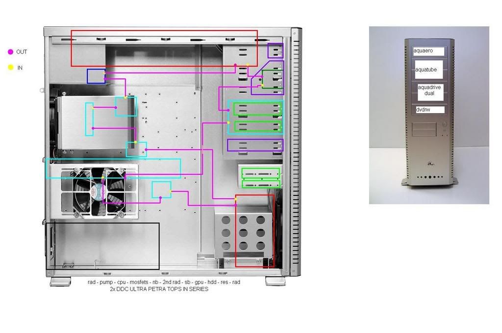

PS. I'm still a little curious as to whether the cooling would be fine:
Configuration isn't final until the parts come:
PA120.3 - 2xDDC Ultra - CPU - Mosfets - NB - PA120.1 - SB - GPU - HDD - Res - Back to PA120.3
As mentioned earlier, pumps will be 2x DDC Ultra in series... or one of these:
Any opinions on power and will it cope would be gratefull.

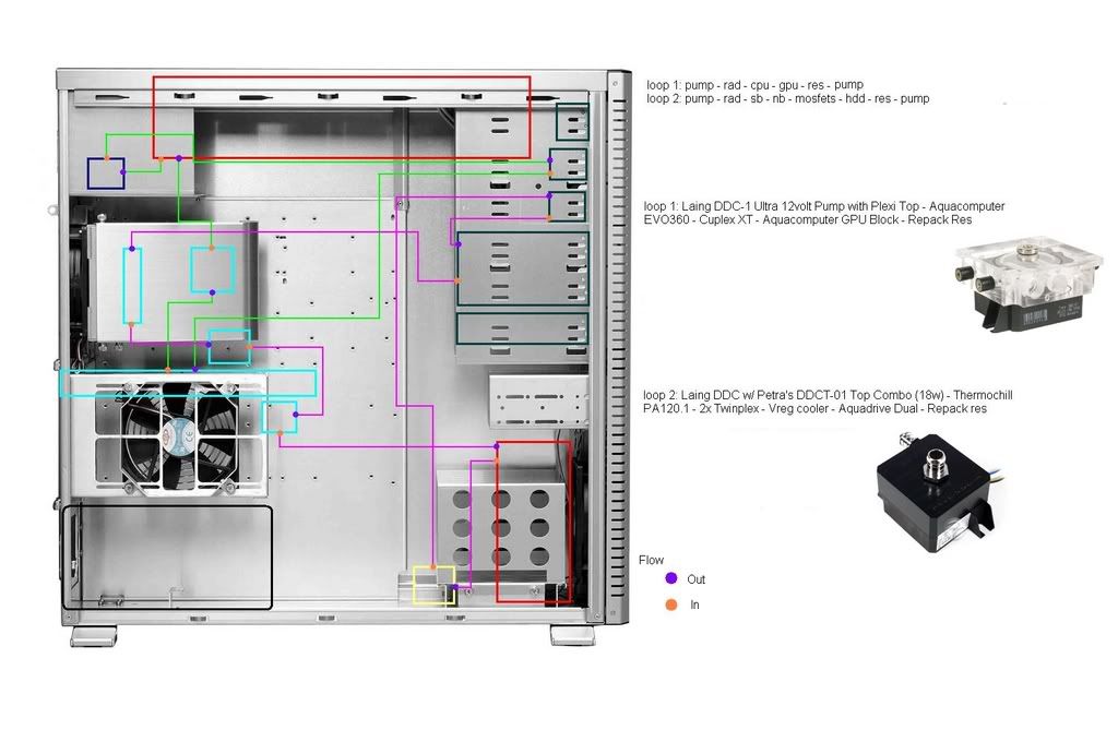

I'm not sure i like the sound of the water setup.6 blocks and 2 rads in 1 loop sounds very restrictive to me.I think 2 seperate loops and not bother cooling mosfets or s/b and maybe h/d's would be better for temps.Also res's are a waste of space,can fit a T line virtually anywhere.
I agree that you should perhaps run two loops with your DDCs. However, a res does help with temps. The greater the mass of water the better, as it takes longer for it to warm up. Imagine if you had the Arctic ocean plumbed in to your system - it'd always be cool :D
(it does however, also take longer to cool down to ambient)
Ye i was thinking of running two loops but as i'm going with one GPU for the moment.. i decided to have it all into one big loop.
I'll eventually split it into two loops when my next graphics card arrives.

Here what i have come up with at the moment.
http://i175.photobucket.com/albums/w140/carbine05/G70/loopconfigv2.jpg
