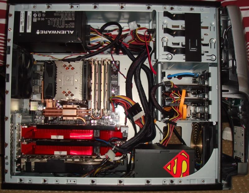

Today we are going to have a tutorial on building a dedicated slave PSU specifically for running a graphics card. I originally did this because I thought that my PSU was not enough. However it ended up not being that but I wanted to finish it any way as I do have a use for it (I'll explain that later).
This guide/tutorial could come in useful to any one who wants to add a second GPU but does not have enough power on tap to run the second one (or only has a single PCIE rail) and has a PSU lying around. However, please take care to read the requirements before doing anything.

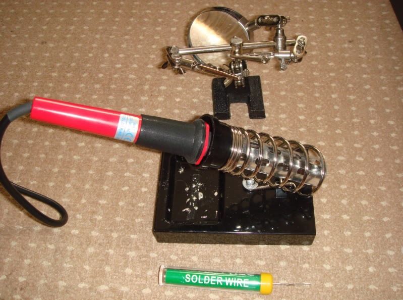

A solder iron
This is my solder iron. There are many others like it, but this one is mine. My solder iron is my best friend. It is my life. I must master it as I must master my life. Without me, my solder is useless. Without my solder iron, I am useless. I must hold my solder iron true. I must solder better than my enemy, who is trying to beat me. I must solder him before he solder me. I will. Before God I swear this creed: my solder iron and myself are defenders of my country, we are the masters of our enemy, we are the saviors of my life. So be it, until there is no enemy, but peace. Amen.

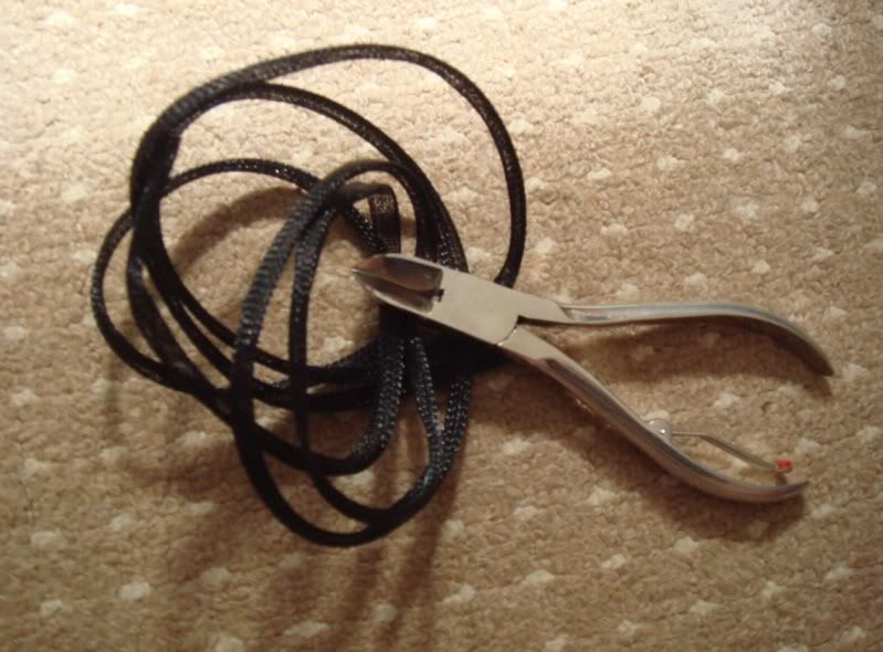

A sharp knife / Wire strippers (see braid pic)

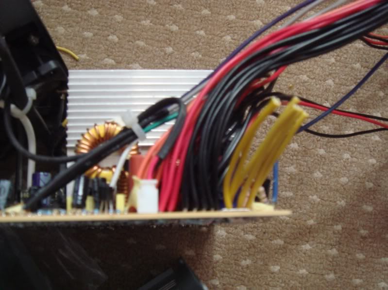

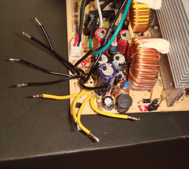

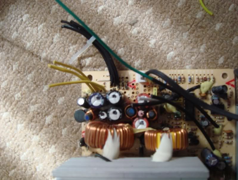

Now obviously this particular PSU being only 350w did not originally come with any PCIE power wires. This isn't a problem as I had two in a box. So we need to work out just what wires we need for this job and then remove all the ones we don't. Believe me, you'll want to do this. It's hard enough finding space in your case for an extra PSU without a plethora load of extra cables and looms to contend with. I won't explain the next part too well as by this stage you really ought to know what you are doing. But, count the wires you want from the rail that provides the power to the molex (LEAVE the ATX one for now) and then flip the circuit over. Now add some solder to your hot solder iron and work it into the clump. Without fresh solder it will not melt. Once it gets hot gently and carefully pull on the wires you do not want, pulling them out.

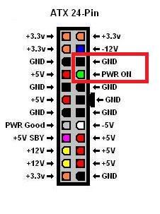

Onto the ATX. There are two wires you absolutely MUST keep now. ATX psus can not be switched on via a switch, they rely on a pulse wire that triggers them into life. This is taken care of normally by your motherboard and power switch. However, even though that will come into this later right now you need to find them and make sure you don't accidentally pull them using the method above. For this we will need an ATX schematic, telling us what wires are what. Pic.
Note the green wire and the black one next to it? OK, the green wire is your pulse/sense wire and the black one directly next to it is your ground. When these two are connected together your power supply will switch on. This is of course taken care of internally by your motherboard and the switch on the front of your case. So, KEEP THESE as well as any 12v (yellow) and common ground (black) wires you will need to use. Please note, if your PSU is dual rail MAKE SURE you take the 12v and ground wires FROM THE SAME RAIL. Crossing the rails is bad, Ray.
Once you are done removing any wires you do not need snip off the ones you do need, but not too short, like this.
Then strip them and tin them with solder. Like this.

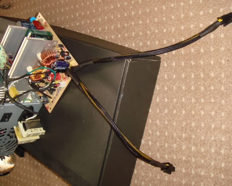

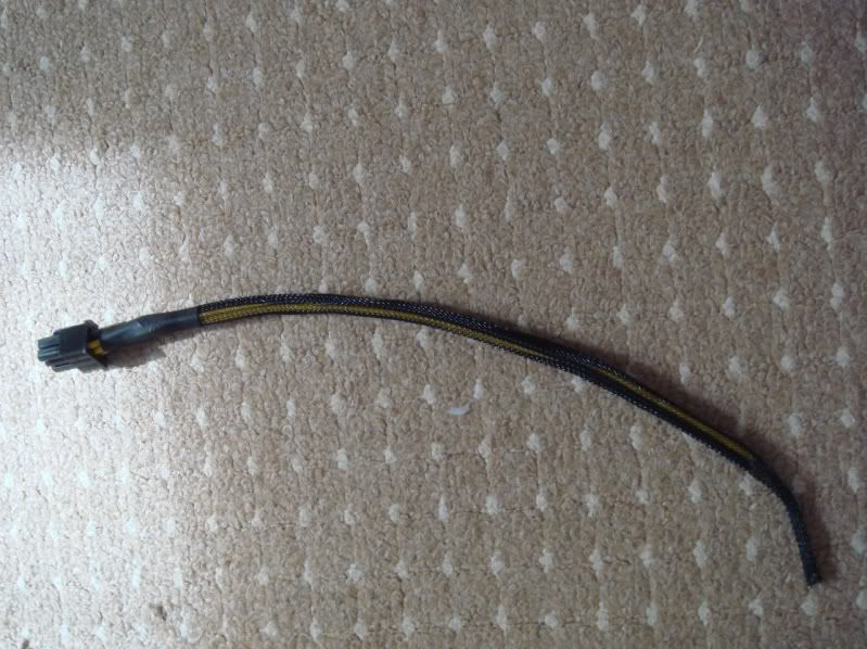

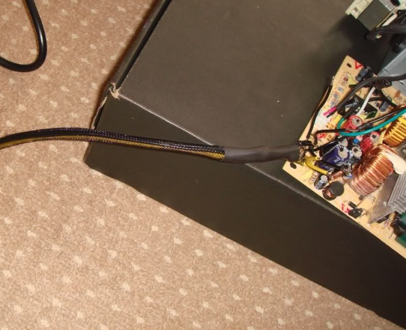

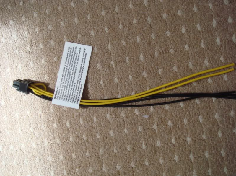

Taking one of your PCIE power cables (pic)
Braid and shrink it, like this
Then slide the braid up the cable and secure it in place with some tape, like this.

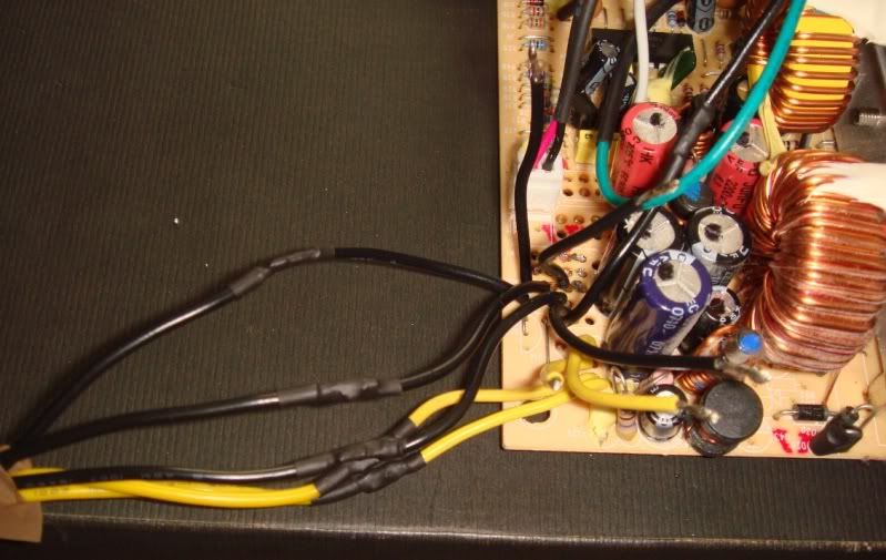

Then strip and tin the ends making sure the stripped parts are the same size as the ones you now have on the PSU end. Now, remembering to slip the shrink over the wires before you solder them, connect them all up. As you do each bunch shrink them down.
One you are done doing that (remember I said to add the shrinks before you started connecting?) bring down the big shrink and heat it, sealing up and covering all of your connections.
And then simply repeat the above steps.

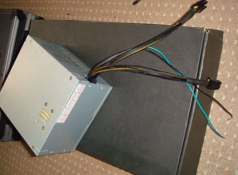

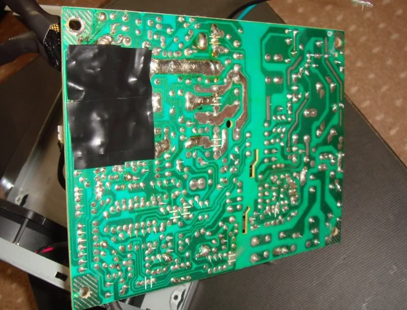

Now, you are about ready to reassemble the PSU. However, on the bottom (where you heated up the solder so that you could remove all of the spare wires) you may have created a bump or have some extra solder. So, to be safe, create a patch using electrical tape. It's better to be safe that sorry !

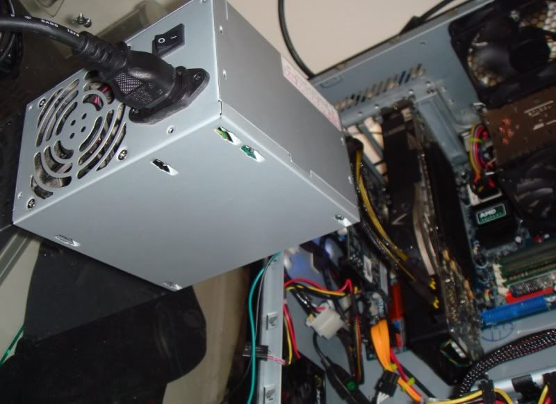

Now reassemble the power supply following the steps you took to take it apart, only in reverse. You should now have something that looks like this.

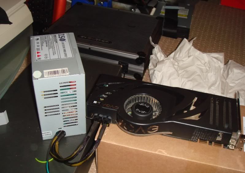

And then remove the power connectors from the card. Now it's time to test it. Firstly connect the power into it and then VERY QUICKLY connect the green pulse wire to the ground. See if your fan comes to life, then TURN IT OFF by disconnecting the two cables. DO NOT leave it running as it will likely blow up as ATX power supplies need a load on them. This is why they don't have a simple switch to turn them on like AT power supplies had.
And you are now ready to test. MAKE SURE YOU USE AN OLD EXPENDABLE VIDEO CARD !
Put the card into your machine and turn on the AUX power supply FIRST. Then as soon as you hear the fan come on switch on your PC.

Now when it comes to fitting you need to connect the green and black wires to the corresponding ones on your existing power supply. They will both recieve a pulse and power up and down together
