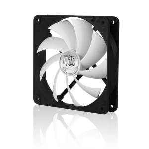

Hi, can I know which fan is the best for hardware lab black ice SR-1 360mm Radiator?
1. Scythe Gentle Typhoon 120mm x 25mm Fan - 1850 RPM
2. ARCTIC F12 PWM
Would like to use in push/pull cofiguration, fan controller is Lamptron FC touch
thanks
+ 1 x 2
Just like to add that the SR-1 is a low density rad made for low rpm fans so could knock that down to the 1250 GT's i believe they are cheaper as well.
If you look at reviews it seems very little difference past the 1k rpm mark and practically none past 1.5
