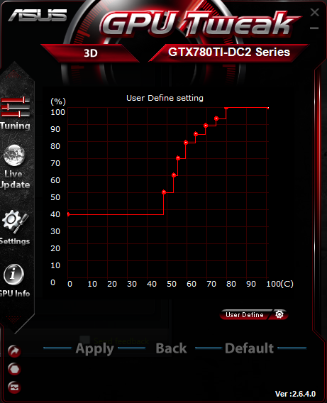

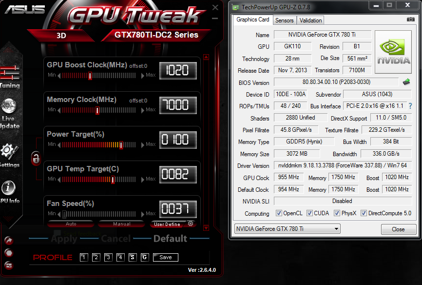

only solution is to use GPU TWEAK!
when I Use GPU tweak... the VRM never go above 92c (on extreme cases).
this is what iv done:
This is on the Default clocks:
http://easycaptures.com/fs/uploaded/773/8790639909.png
FAN:
http://easycaptures.com/fs/uploaded/773/2386247207.png
AND this is on the little OC: (same FAN as aabove)
http://easycaptures.com/fs/uploaded/773/6758552269.png
