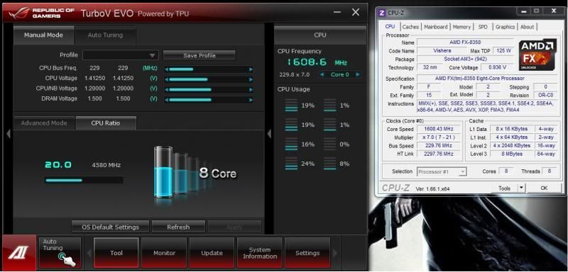

Hi, I used this feature(1st pic) then on the 2nd pic cpu ratio says 20 & 4580mhz. What does that mean?
And on cpu-z core speed = 1608.43mhz and multiplier = 7 ..
Is this normal?
Thanks

After what i can see, your pc is not doing anything. So the cpu is down clocking it self to save power and when you will use it, it will go up to the 20 multi x busclock to get the 4600 mhz clock.
Try to stress test the cpu and see what is going on and come back friend.
OCCT is a great program to test your cpu max out ;-)
Use CPU : LINPACK and set to:
  • 64 bits
  • AVX capable Linpack
  • Use all logical cores
Then it will use your CPU full out.

I have an asus board but with an Intel cpu. I don't know how to overclock an amd cpu but my advice would be don't trust that "level up" feature. Better to overclock manually on the bios.
I think that's what happened to mine. So I'll be doing the bios thing next time. Thanks for the advice
