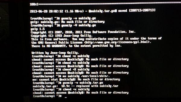

Tried that I'm getting the message gzip: sakis3d.tar.gz: not in gzip format
Huh, I think there might be a difference in the archive format between the two archives
the different servers provide.
If you have the program tar available you could also try this (I have tried it
on my machine and this does work for me):
After the wget line, instead of continuing with gunzip, enter
Code:
[root@alarmpi ~]# tar -xf sakis3g.tar.gz
This does unpack the sakis3g.tar.gz archive and leaves me with a file named
sakis3g in my directory.
From then on:
Code:
[root@alarmpi ~]# chmod +x sakis3g
[root@alarmpi ~]# mv sakis3g /usr/local/sbin/.
[root@alarmpi ~]# cat /etc/sakis3g.conf
If you still have trouble unpacking the archive I've unpacked it and uploaded it to
my server. If you want to go that route, use:
Code:
[root@alarmpi ~]# pacman -S ppp
[root@alarmpi ~]# wget -O sakis3g "http://www.alpenwasser.net/repository/files/sakis3g"
