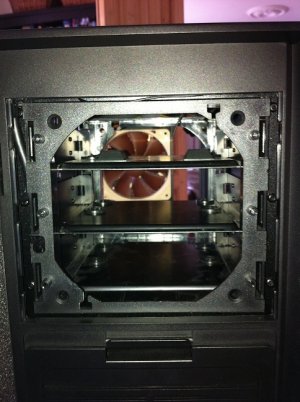

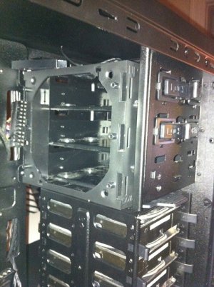

So i decided to see if a full 3 hdd bay with fan holders could fit in the 3, optical bays. And after dismounting the hot swap bay that i never found a use for in a server hidden away in a closet, so i tried mounting it, and fit like a glove, just gave it a little push and it lines up perfectly with mounting holes and everything. If i didnt know any better i would say that Silverstone and Coolermaster collaborated about this, "hey if someone buys a Raven RV-03 and a Silencio 550, lets give him some more options, if he needs it". Marvelous

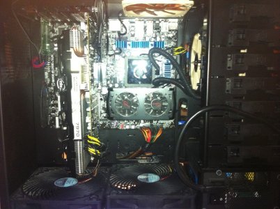

My cosair H80 fits right into the space left open when you dismount both HDD trays, you cannot fit an optical drive when its mounted there, but who needs one of these anyway, you can however fit one or two extra fans to the front if you want to, i have only fitted one extra, to blow some air over my psu and feed some air to the ram sticks.
Here you can see from the front how it just fits really snug in there, i just need to mount a dust filter there, imagine that wont be too taxing.
And theres room to mount a second fan, inside the case if you feel like you dont have enough air going through.
So there we go, a cheap case, turned into a 10 3,5" drive server monster!
