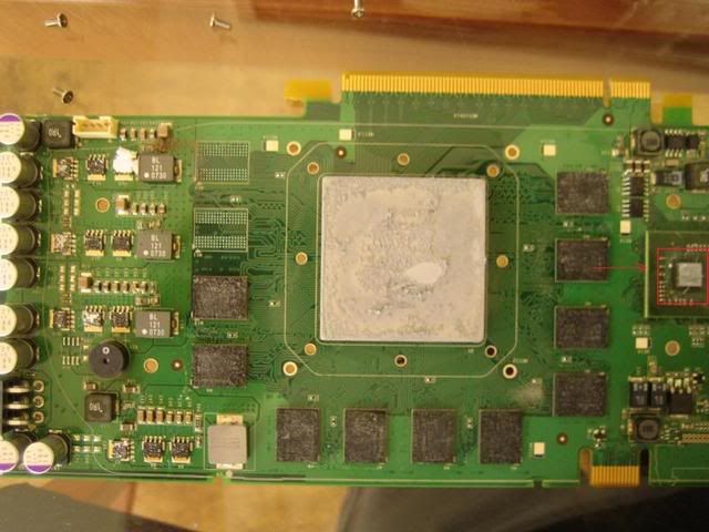

Question no2 I am waiting for a EK block to arrive for my 8800gtx i have got these pads from the shop LINK and i presume paste goes on the GPU and ram but what goes on the chip that sits at the back of the card like Billy no mates, LINK (on far right) Pad or paste? Also the pads have a brown like cloth substance on one side and plastic on the other. I presume the plastic you peel off but what about the brown side does this stay on and do they go on brown or blue side to chip?

Question no2 I am waiting for a EK block to arrive for my 8800gtx i have got these pads from the shop and i presume paste goes on the GPU and ram but what goes on the chip that sits at the back of the card like Billy no mates, LINK (on far right) Pad or paste? Also the pads have a brown like cloth substance on one side and plastic on the other. I presume the plastic you peel off but what about the brown side does this stay on and do they go on brown or blue side to chip?
* Arctic Ceramique usually goes on there mate, unless there is a pad supplied.
* The side that you pulled the white tape off sticks directly onto the RAM.

I have bought the block second hand so it will not come with any grease/pads. The ones I ordered look like they are for the tiny Mosfets only, so I presumed everything else will have paste on. I was just checking as the block is due tomorrow and don’t want any more delays with the build. As for White tape?? There is none there is clear film so I will presume that side will go to the ram?

When you purchase any of the waterblocks from EK they come with thermal pads for mosfets etc, but yes, AC Ceramique for the RAM, GPU and the small vid processing chip that you pointed out earlier. My apologies :)

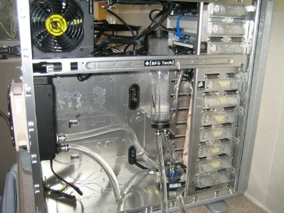

I have a bit of a weird setup as i don’t want a rad on the outside.
I use a 120.1 + 120.2 So was thinking
Res - Pump - 120.1 - NB - GPU - 120.2 - CPU - Res
Pump to 120.1 first just because its in line with the outlet of the pump. I thought 102.2 before CPU as the CPU will be generating most heat.
So the problems (tight bends) will be from NB to the GPU block.

Ok! Are you talking as tight a curve as what I have from NB to res, or tighter?

It’s hard to visualise it in possession ad the block is in royal mails hands at the moment and due to land tomorrow morning...... But I would say allot tighter as I have just measured from NB block to PCI-e slot is only 1 inch or 2.5cm for the young ones out there.
Looking at your set up (which is v nice by the way) it would be easier if i go res – pump – 120.1 – NB – 120.2 – CPU – GPU – res. Would you think this will work OK in that order?

Wow that is tight! Running your loop the way that you suggested would be fine...especially if it makes the loop easier to work with and eliminates any possible kinks. Just make sure that you keep the res b4 pump and you should be fine. If you get a chance before tomorrow, posting up a pic will help us look for any alternatives for you. Thanks for the kind comment too btw :)
