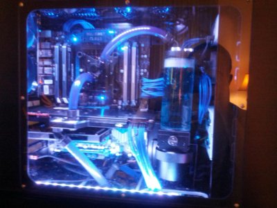

Hey guys,
When I was testing my 3930k on an 100i, everything seemed fine with my BIOS reading temps in the low 30s. Now that I've finished and attached my Apogee HD I'm getting temps around the mid 40s. Granted the GPU is in the loop but I've never seen idle temps this high on water without something being wrong. I've already reapplied thermal paste and reseated the waterblock. Can anyone think of something that I'm doing wrong? I've got a 480mm Black Ice SR-1 radiator cooling everything and I don't think I don't have enough rad space.
EDIT: Oh, btw, ambient room temp is around 24C

At that ambient,40's sounds a touch high...
Okay,go thru the check list.
1. Did you remove the sticker on the block face? You wouldnt be the first to do that.
2. What pump are you using and what speed?
3. What speed are you fans running and what are they?
Pic of the loop will help.

1. This is a block I've been using for about a year now so yes.
2. MCP655 and currently speed is set at max. Plan to lower it back down to about 3 for normal use.
3. Silverstone AP-121 and at 1450rpm right now. They're configured in pull and as an intake.
Only difference on the rig between now and the test was the card was H100 vs custom loop so components otherwise are the same.
EDIT: Whoops. Forgot the photo. Rad's in the basement of the case.
EDIT2: Oh, and btw, my video card is idling at 30C so the rest of the loop seems to be doing it's job. Hence why I thought I'm missing something related to the CPU block.

I believe you need to use the raised ports on this block,i may be wrong but im sure someone else had a problem like this with his apogee....
EDIT: Having looked at the block top,you have the fittings on the wrong ports,You must use the raised ports in the IN/OUT config displayed on the top
