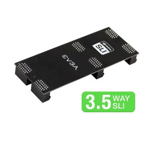

well thanks for your post , but what I was looking for was a 3 way SLI setup with extra spacing between cards 1 and 2 , and between 2 and 3 normal space. I think its callled 3.5 way SLI atleast thats how they call the SLI bridge.
Let me make it easier :) According to MSI, if I want to use 3 way SLI with a 40 lanes CPU ( my 5930k ) I should use slot 1 , 4 and 6 that would result in a this SLI bridge as seen on the picture. Now I wonder does anyone here have experence with this and maybe have a picture of it. Thnx in advance and sorry if I was not to the point :)
it also depends on which card you'll be buying to go triple SLI, there are 2 slot cards and 3 slot cards, you might want to consider it too
this took me one sec to look for but i think this is what you mean right?
If I was going to use 3 cards then water-cooling would have to be a big consideration in the component choice. Seeing as SLI bridges are all dual spaced 1, 4, 6 wouldn't work out. If it was 1, 4, 7 you could use pipes to link them and if it was 1, 3, 7 you could use a Quad parrallel link with one slot blanked although it would look much neater if the cards were evenly spaced.
In short I would only go for dual spaced or triple spaced configs, not two then three. Not many motherboards support triple slot spacing for 3 cards with decent PCIe bandwidth.
