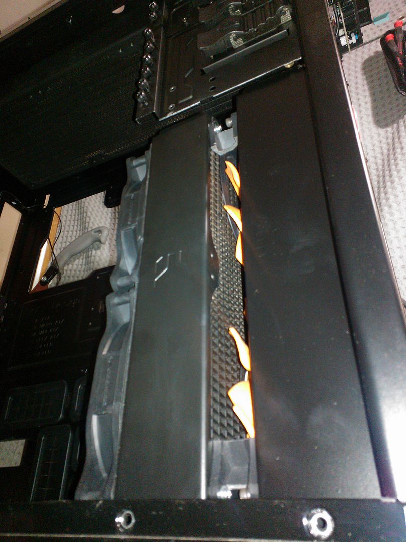

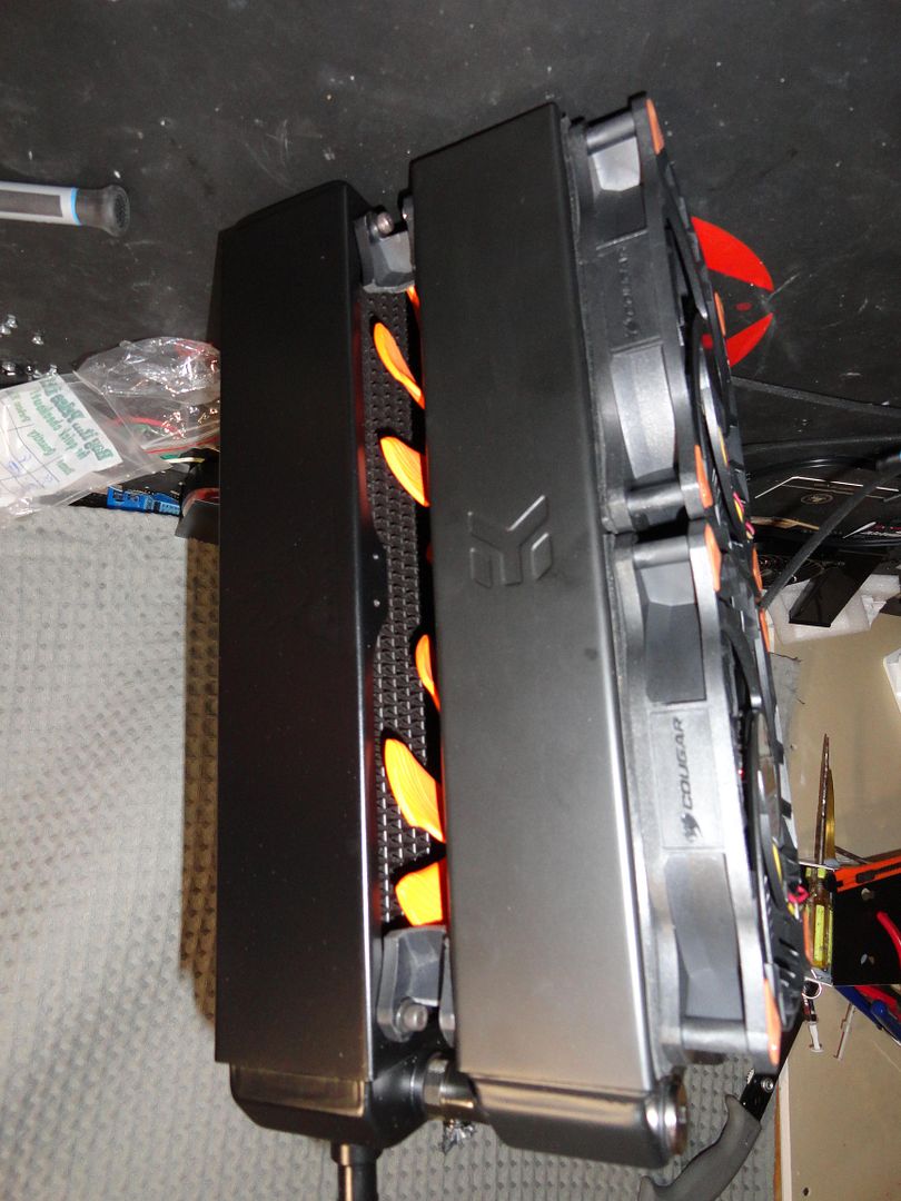

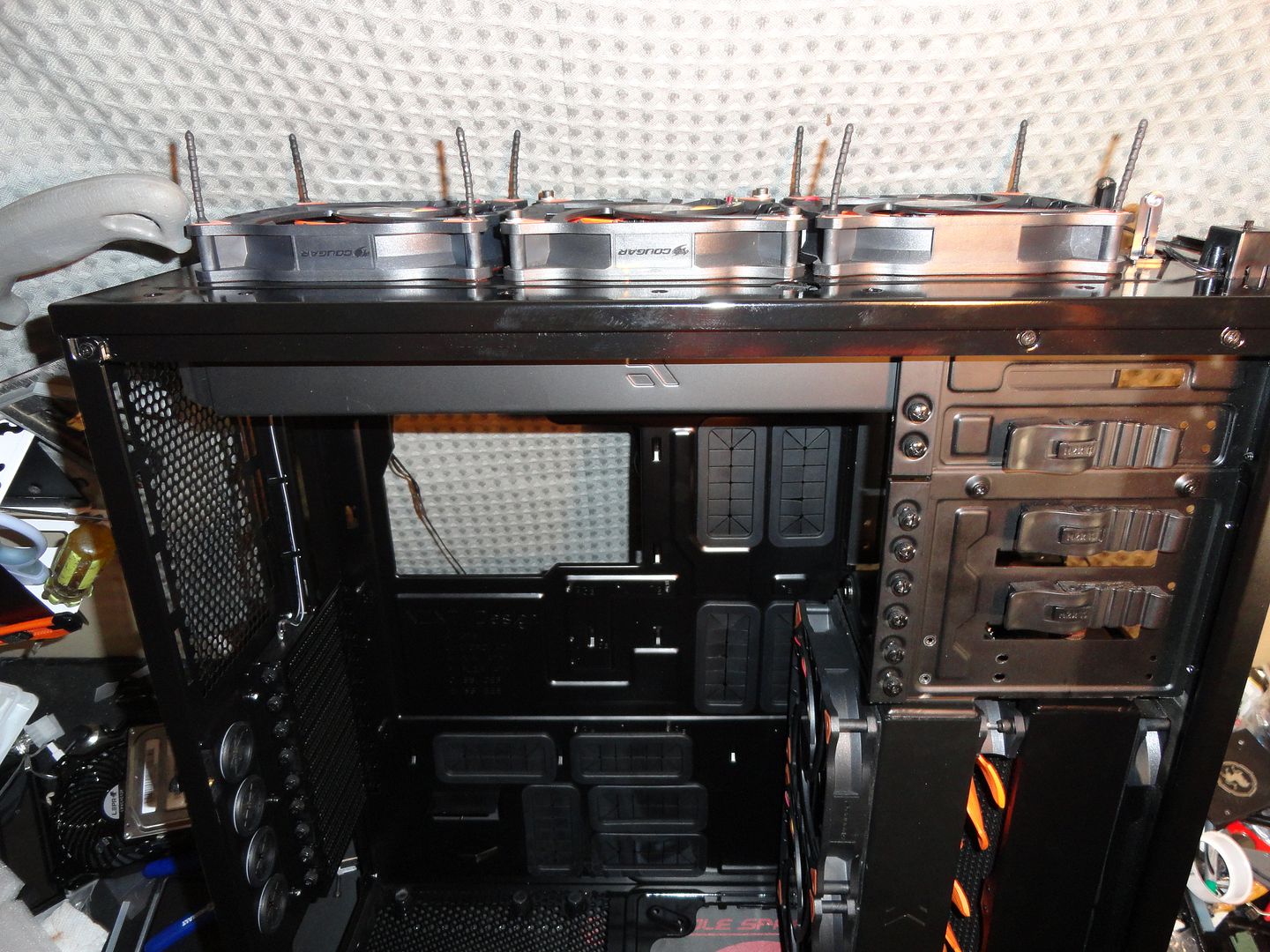

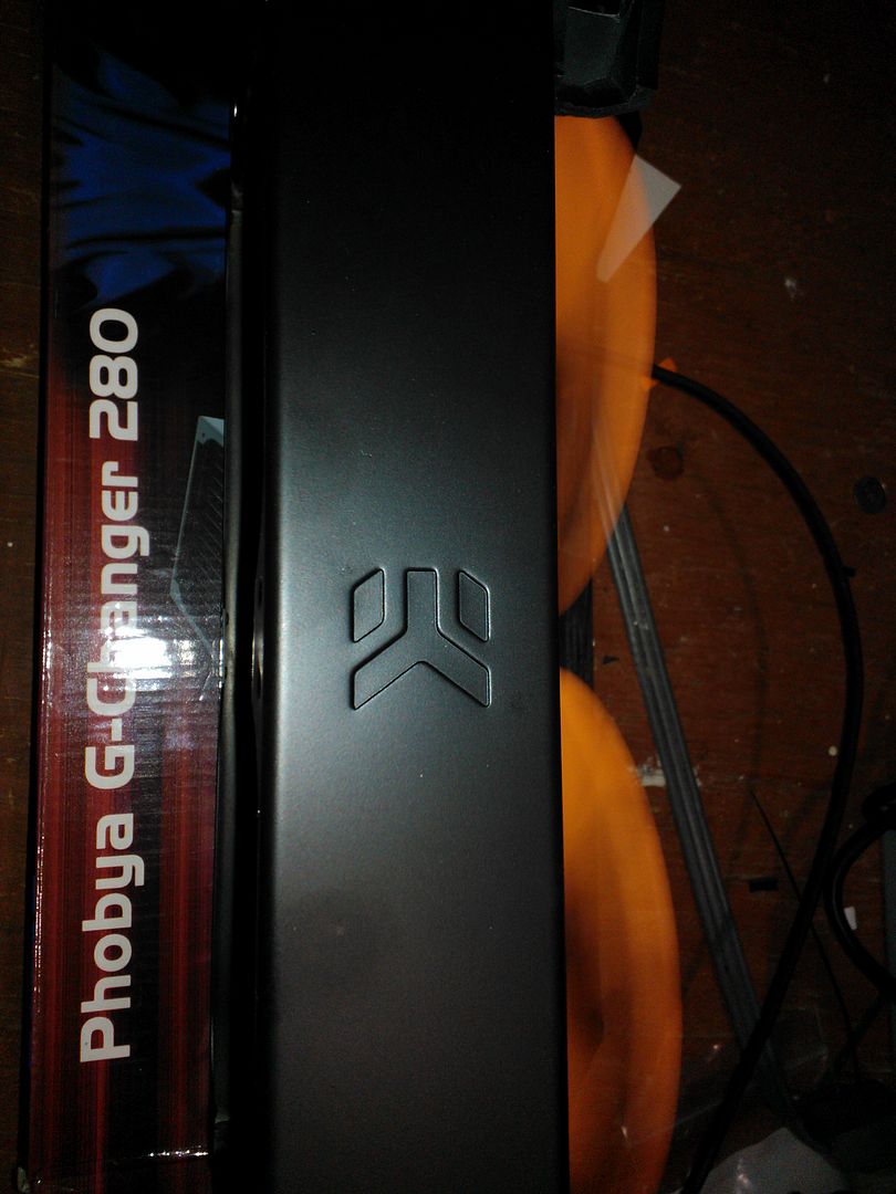

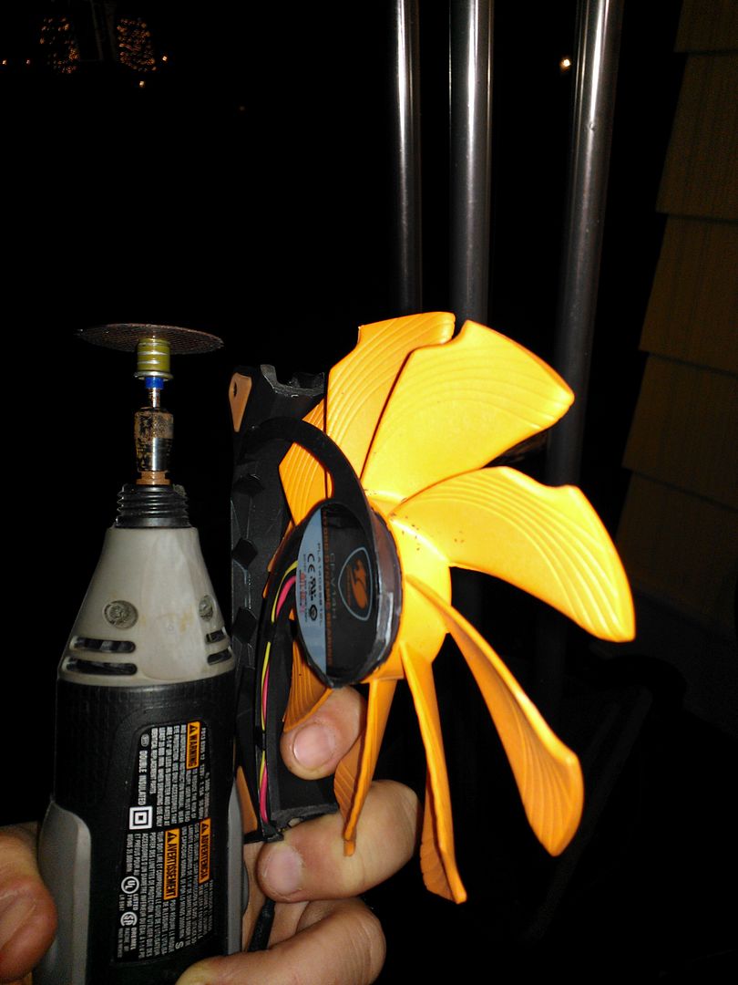

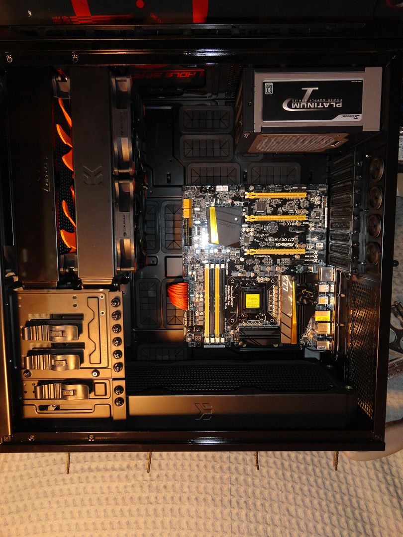

ok....so lets start with the front radiator bank.....fan modding

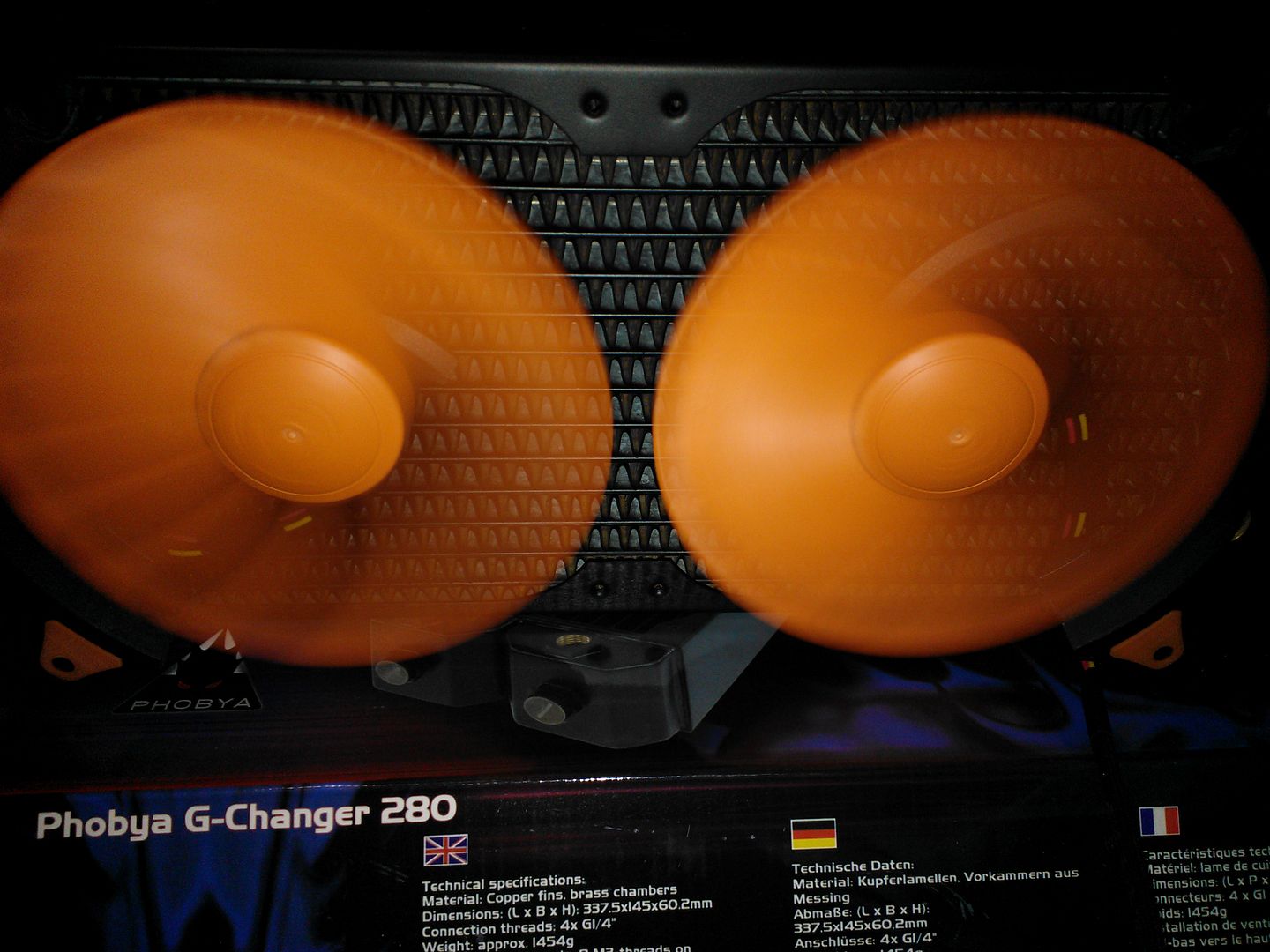

with open fans in the middle im going for a "Zalman cnps12" type setup....enough to move the air through...and actually when all 6 fans spin, the middle set actually seems to pull more air in...wierd
so the sheens are off a 'lil, iknow i know....it's what i had tried to paint it but satin is too glossy and flat
is too flat.....seems like im stuck unless i paint'em all.....

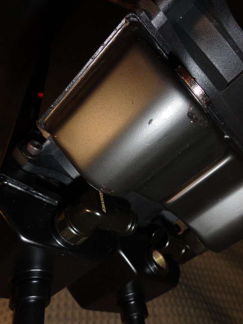

connections dont line up, so direct fit is out, in comes the 90deg rotaries from koolance

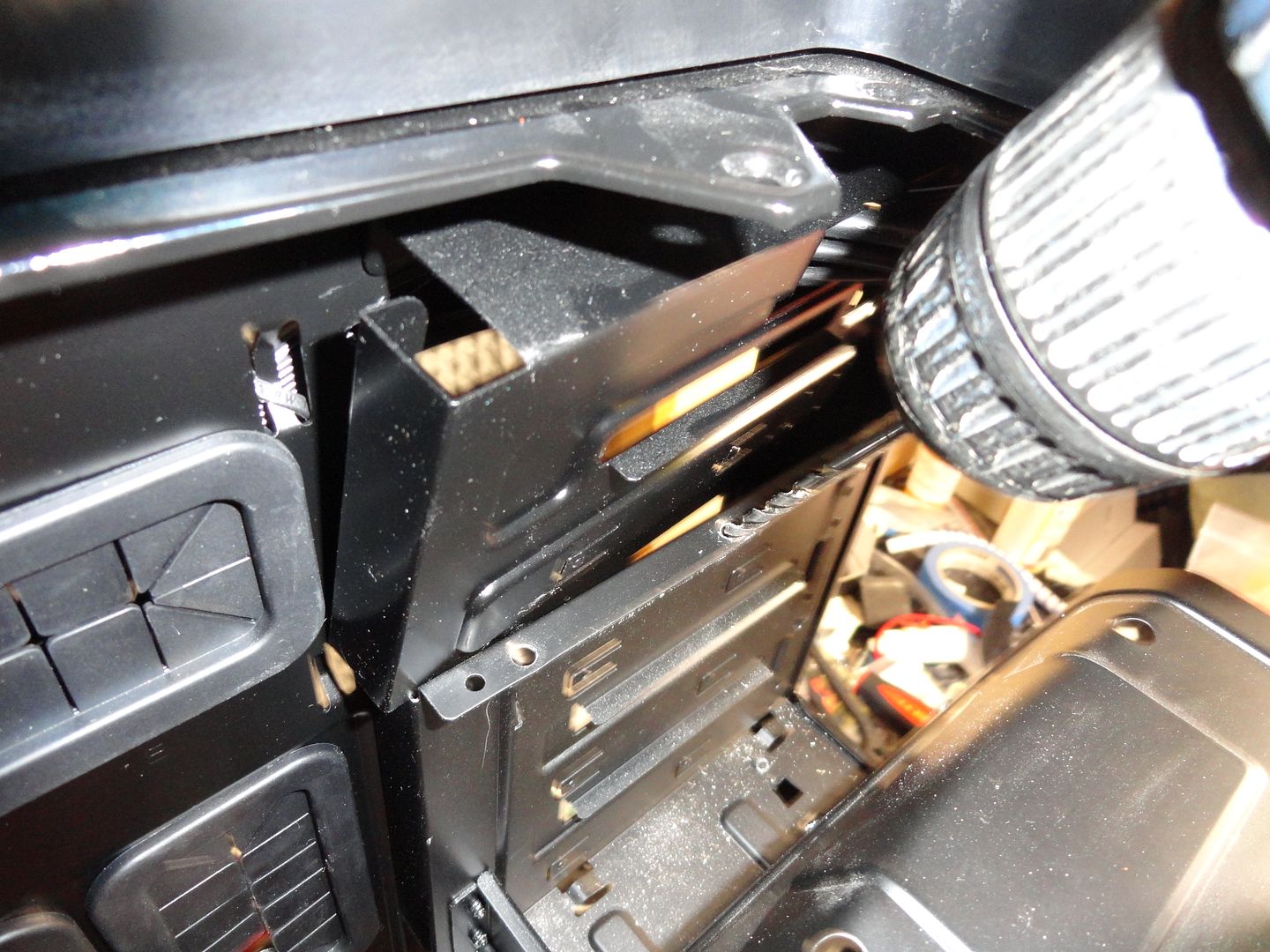

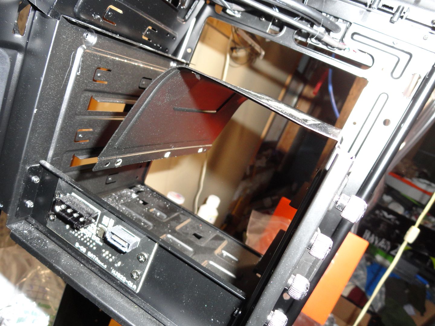

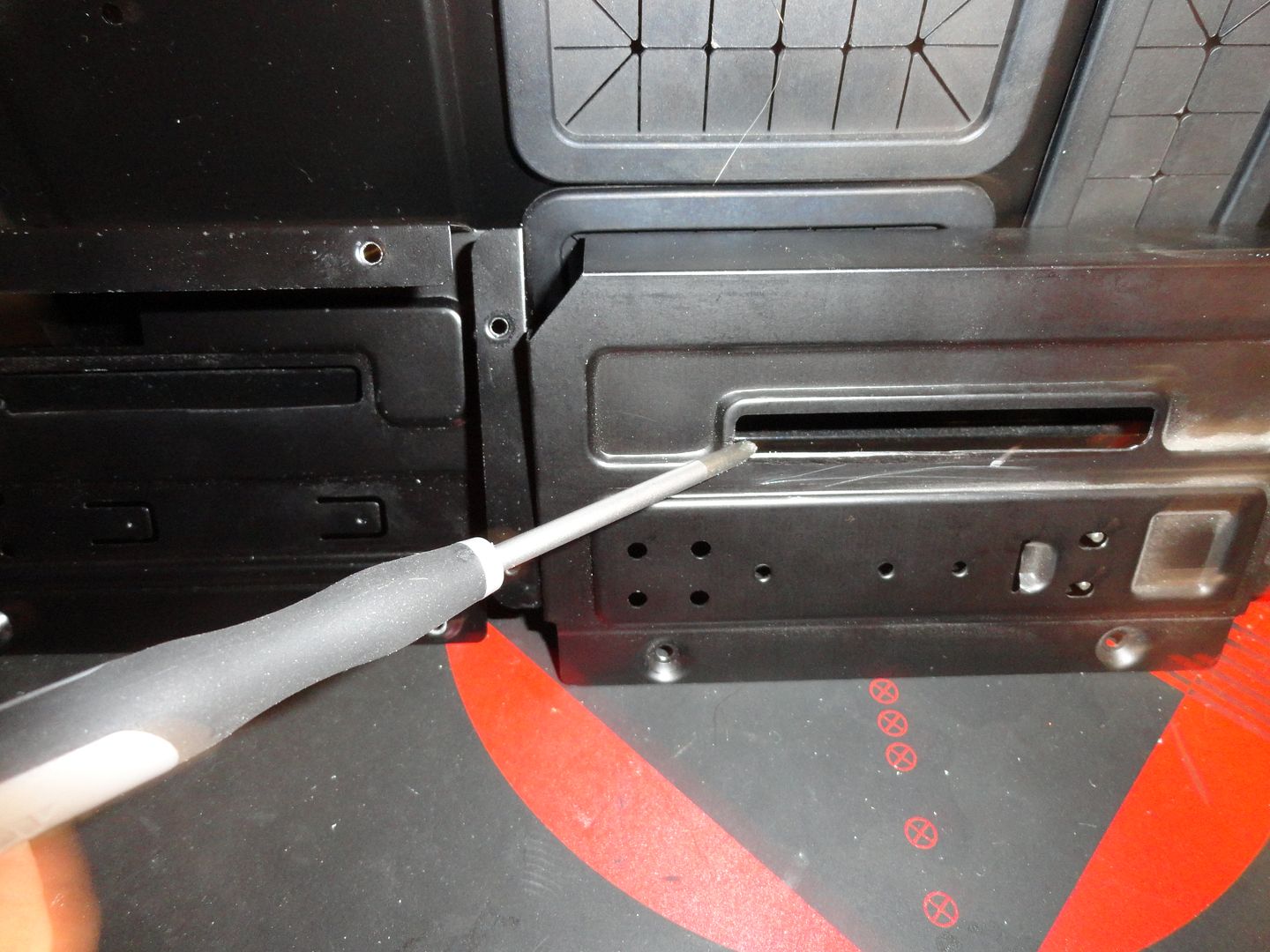

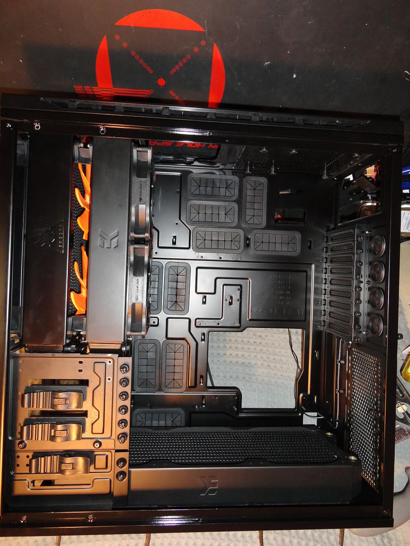

case modz.....

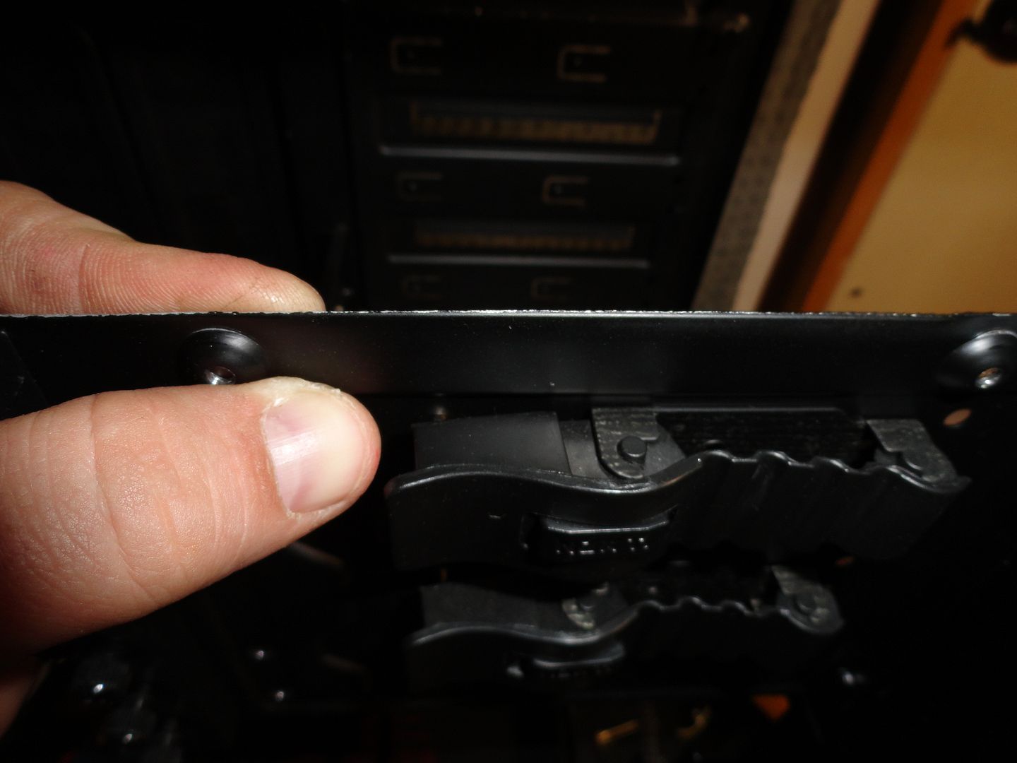

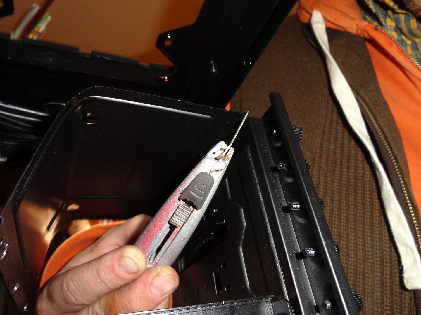

score and snap is my preferred method of op....
lil sandpaper and that'l'do

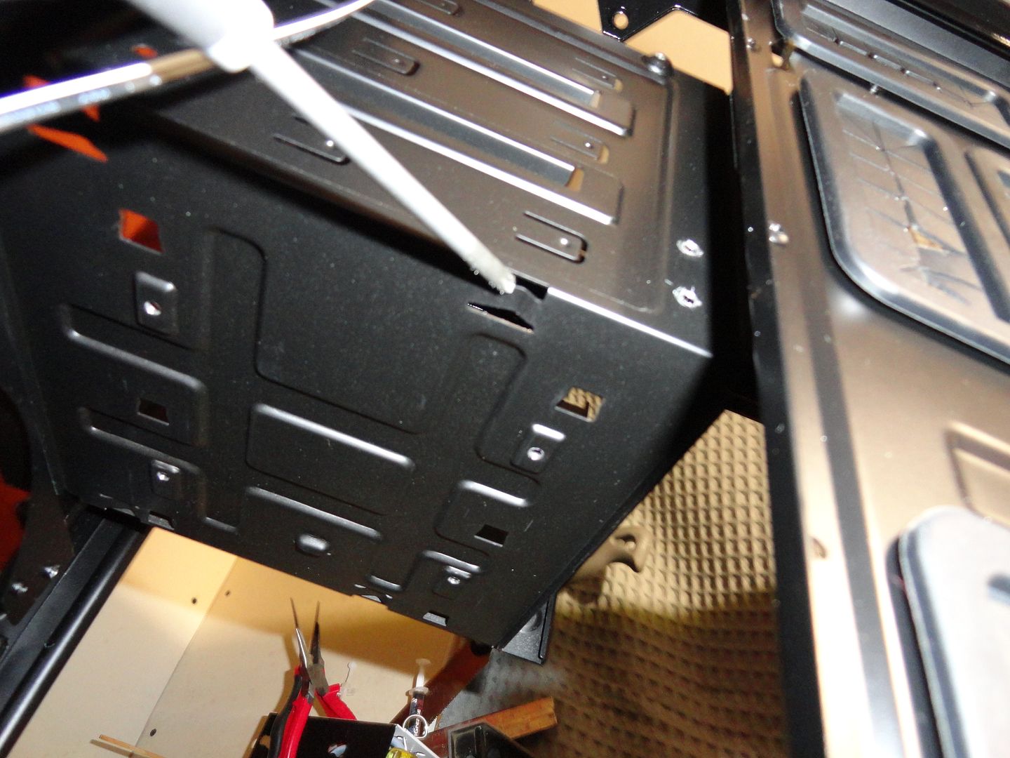

remove the top 5 1/4 vertical guides
and the botom of the 5 1/4 bay.....

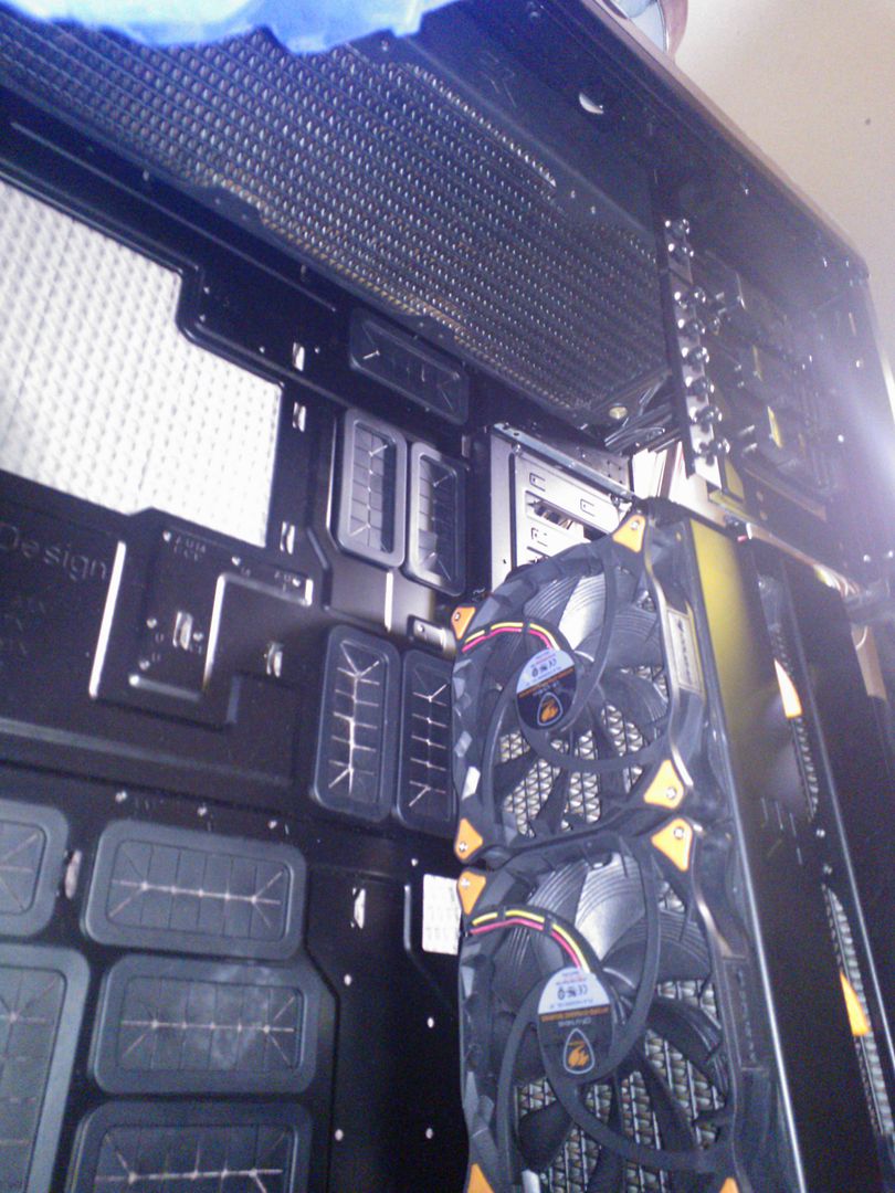

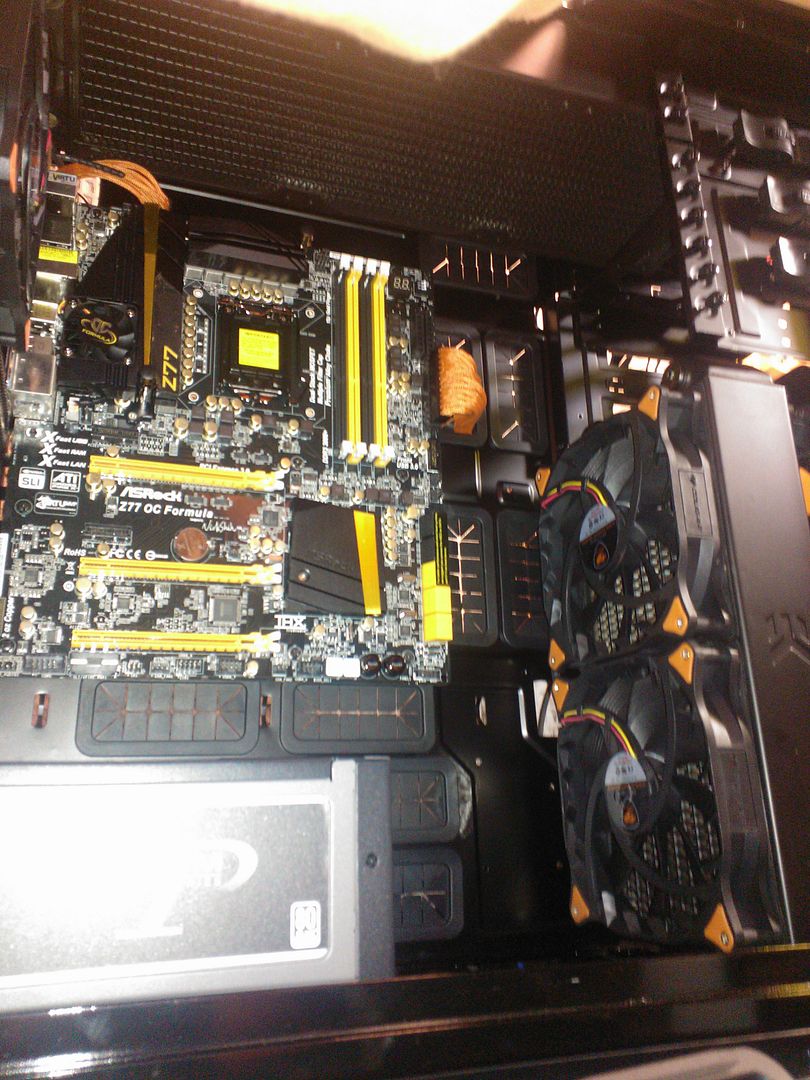

and i can finally mount the rad bank!!!
ill post some more tomorrow ill leave you with a messy shot.....
ahhh....couldnt wait
thanx for watching

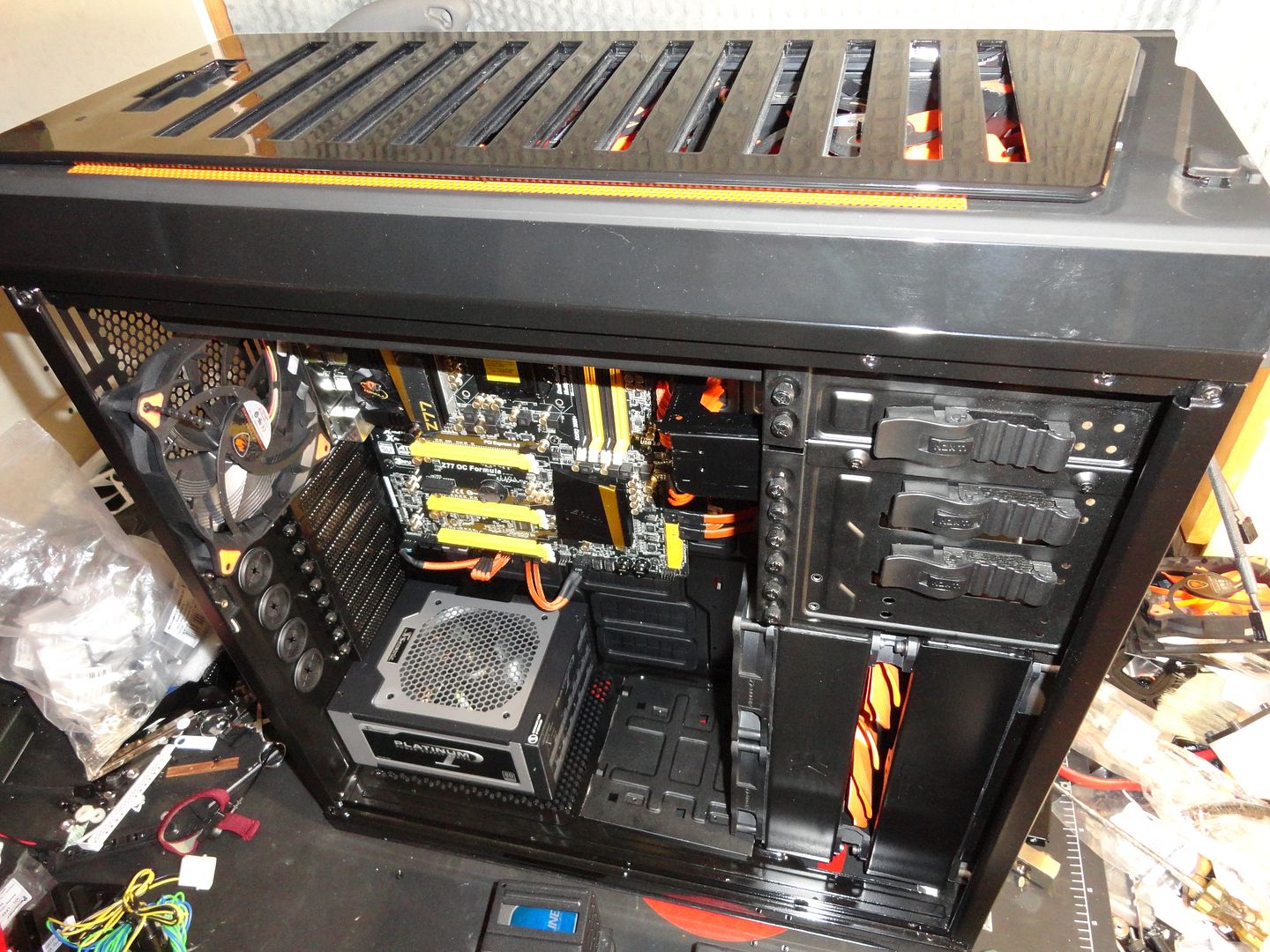

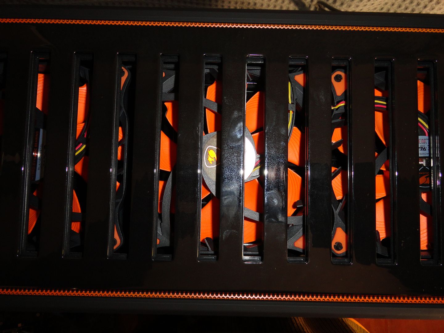

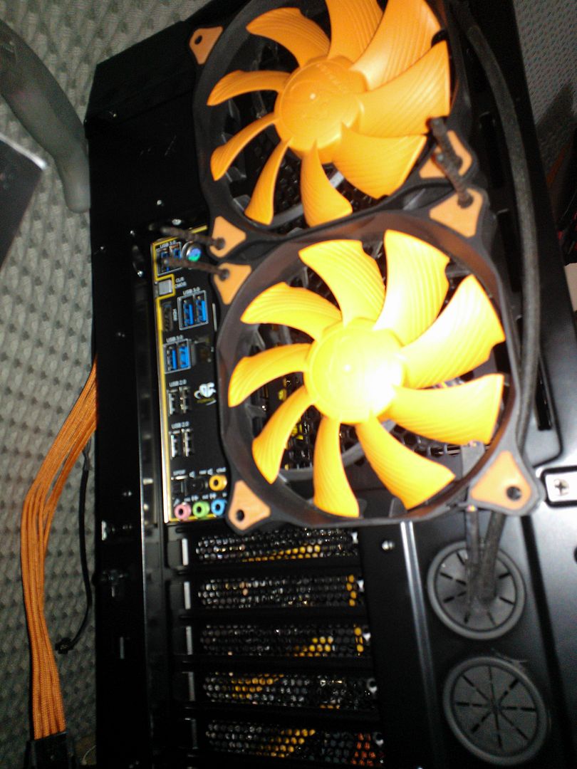

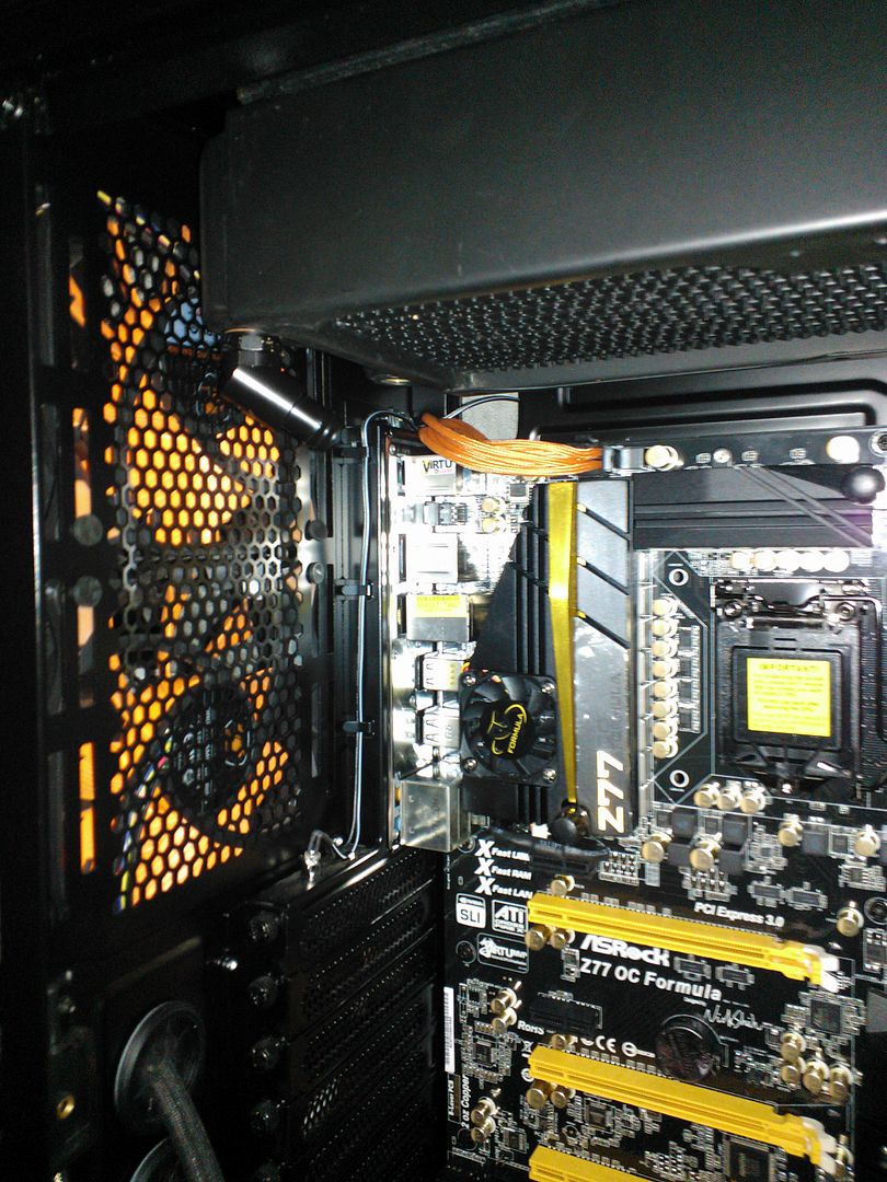

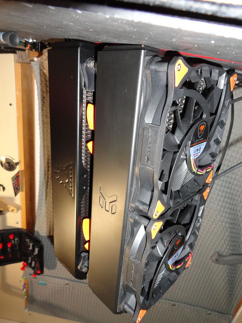

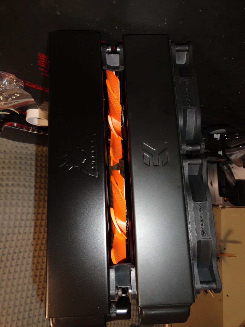

also....im a stickler for positive pressure, the fitting wont let me use a 140fan and the orange 120 just didnt look right there.....whacha guys think bout this....
obviously id hide the wires better than that.....
How is the airflow affected with the frame removed? I'd take a guess that the air isn't directed through the rad any longer, but sideways instead. It does look pretty damn cool though.
i used a match to test just that......it actually sucks MORE air in than would have otherwise....... pleasant surprise, cant claim i knew what would happen....
Crazy. It'd be interesting for someone with the equipment to test this.
my best guess is that it works on the same principal as the CoolerMaster Xcalliber series...those fans actually draw air in through its frame from negative air pressure.....makes em loud as funk tho......

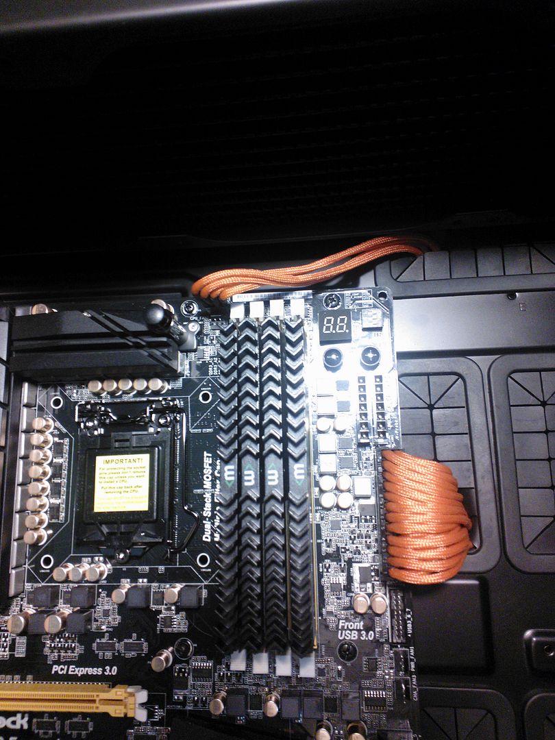

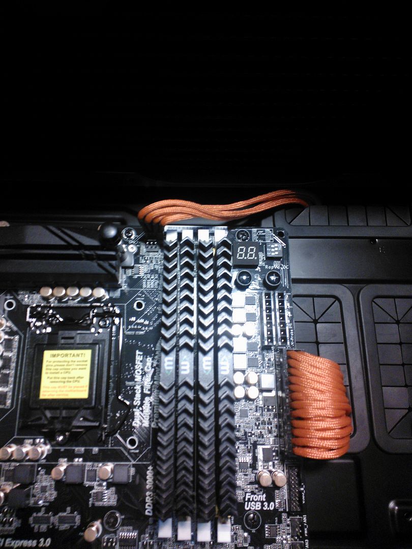

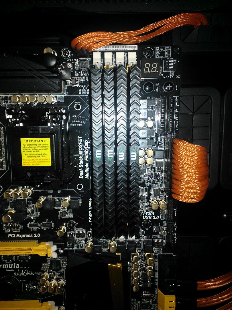

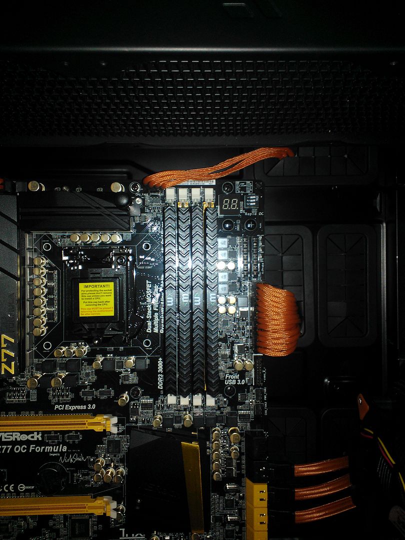

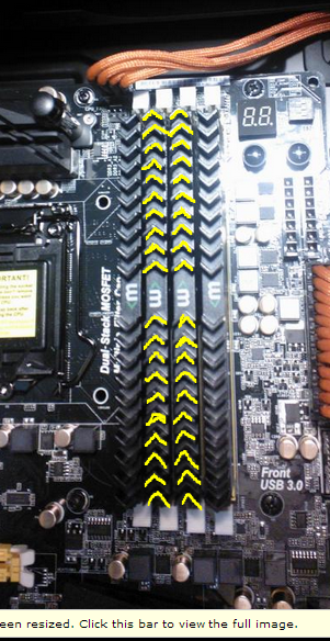

ok.... so one of lthe cooler things about mushkin ridgeback ram is that you can "flip" the top part (the ridge) so the arrows can go up or down.....i was thinking of going up down up down, but the "<M" logo looked wierd alternating what i think im going to do is this, although i will be painting just the tips of two of the rows either yellow or orange....yet to decide on a color...
oh my....too many options...i think i know which one i like tho......
feel free to chime in.....keep in mind ill be painting the tips yellow on 2 sticks
for the record....i think i like down up up down
