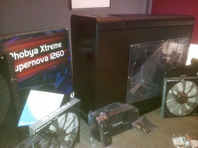

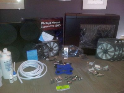

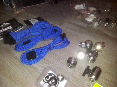

I'll be building the water loop this weekend. I have also noticed that many cables that come standard with the PSU are a bit short to allow decent placement/management, so I'll need to pop over to the shop to get some extensions. And also new cables for my screens as these are also to short now.
Rad will be "art work" for the moment as I do not have the stand ... but it will be out of sight :rolleyes:
Internal loop should be good, cant wait to get it in.
Got the PCI bracket to get the loop out, and all the other bits.
I had build all the parts in the FT02 and I have been running on air cooling, no OC ... I must say the FT02 runs very quiet on air as well. Certainly to recommend for Air coolers as well. (also allowed me to evaluate cable length and placement, placement of my SSD's, ...)

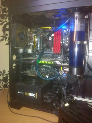

Build Complete!!
Well ... IT IS DONE ...
Is this better or at least an improvement!? :cool:
I'm very happy with the result.
The system runs stable at 4.7Ghz @ 1.28V
(did not spend to much time getting Voltage lower as temps are OK)
Temp at idle is: 31°C
Temp at 100% load in blend Prim95: 66°C
Temp at 100% load in Large FFT (max heat): 72°C
So very nice, I'm happy.
Of course the fans are inaudible on the 1260 RAD.

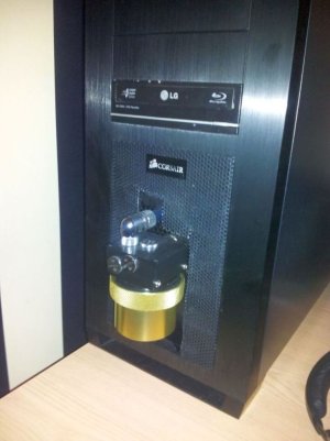

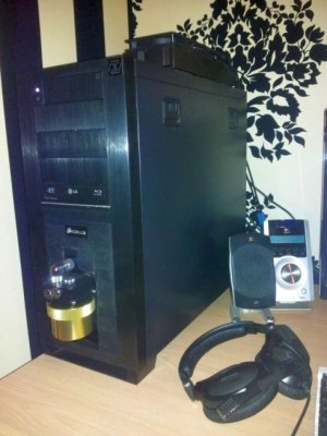

eeehh ... Rad is in between desk and wall ... i have 0.5m there nothing above, so very well ventilated. So it is difficult to take pic.
It is a Phobya Xtreme SUPERNOVA 1260.
With 4x 200mm Fans on it and a D5 pump.
The pump + Rad + Res are on Quick Disconnects.
For the moment it is a "engineerd" solution as I do not have the radstand; yet.
