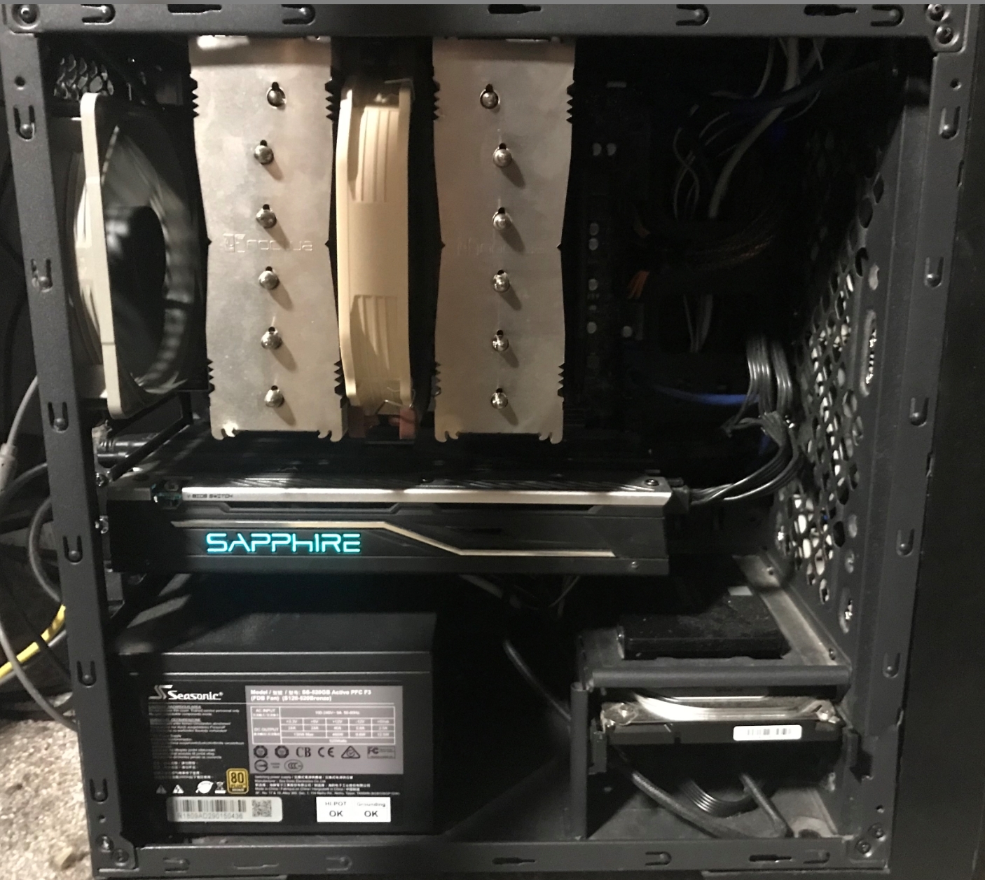

The PC I usually use for gaming did its job well but while being insanely loud and a bit booky. Moved into a room with quite a thick carpet and the unfiltered 23cm side fan on my PC had to go, and the loud old HD7870XT went with it, as well as any other old case fans. Instead there's an RX580 Nitro, and
2x Noctua NF-P12 redux-1300 PWM
2x Noctua NF-S12B redux-1200 PWM
A 4 way fan splitter for the above and to replace the dying CM212Evo fan
1x Noctua NF-P12 redux-1700 PWM
Now it's whisper silent even with an OC

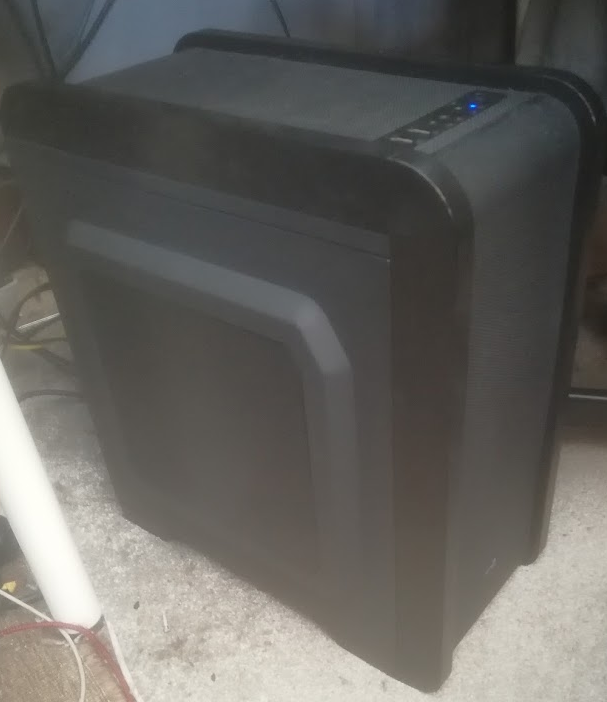

But in all seriousness it's a good idea to get a flat hard cleanable surface for it to sit on. Carpet will absolutely destroy the inside of your case within a week. I'd definitely clean the area often even if you rest it on something

Yeah I've been looking into get a large wooden piece cut so I can mount my wheel's pedals too, for now just giving it regular cleans and hoovers nearby.

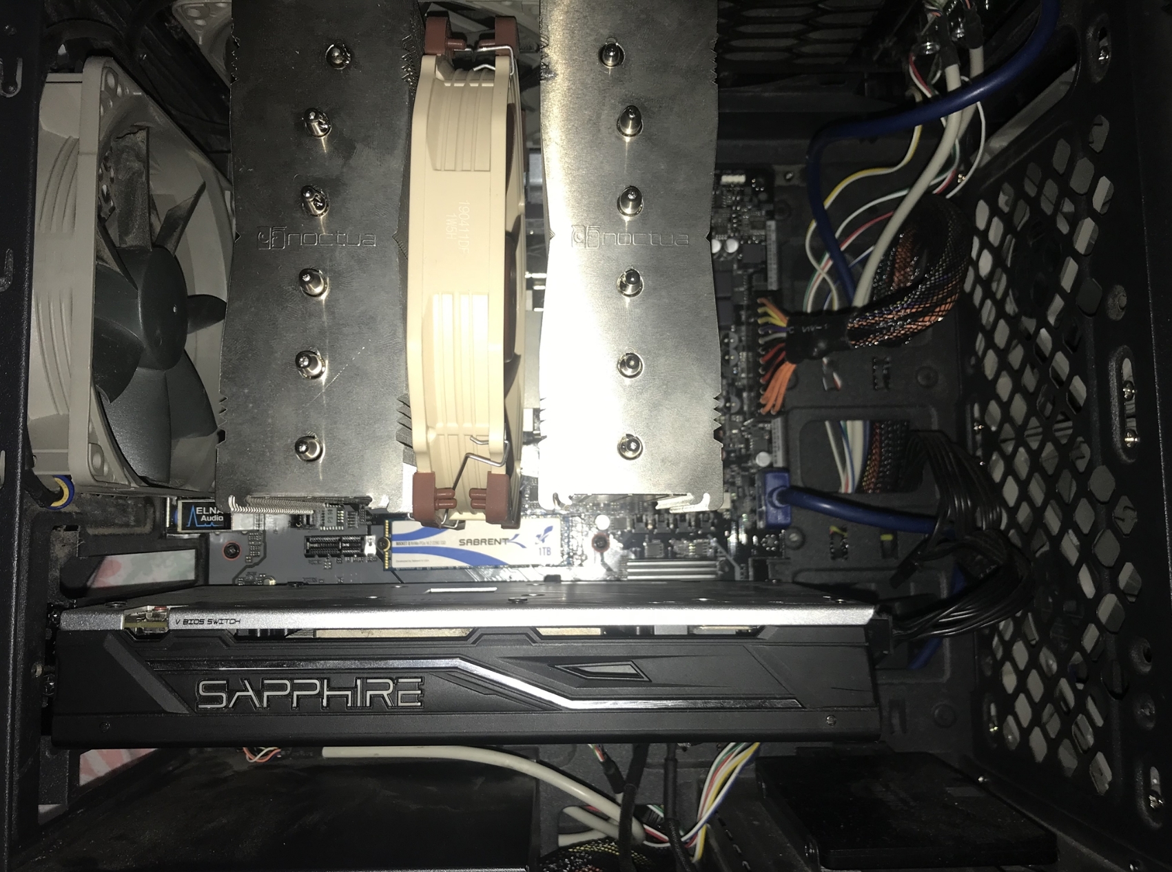

My old CM212 Evo didn't fit after I recently upgraded to Ryzen(And AM4 brackets with shipping to UK cost as much as a new cooler), I was planning to get an AIO watercooler or an NH-D-15 (Think it would just about fit height wise), this is how things look at the moment (Two fans right of the honeycomb on the right):
(Also finally got a phone without a smashed camera so it doesn't look like I've constantly hotboxed my room)
Q7IBCDljZITk46yMiA59q9LWCRAEgt1N46rFYkdB58zqRoSY_D31ZEFan0ZfAtXQGWmJ1lfq4wybLFU4i3Gs7PgAGvuGyLhBRuwesQq9PpoiTH91l78rMeHdUOH1cIM5LT4VKseu72Tf0YLkAfv7fIyZox52bT_bc2eKNiENJR2RNpLmSJ5y1znshvKDDVBMLuQ-JiP9RCG5IPzEeR6FAg1ckDL9ZbGtn_ZEohF_GiKfqJX7Lquvu3PN8dx3RYbowuigJs5mYHy5h-NSuafvacKRzaSRSJllRwpkprQcd9L3yq_7D2bFqK_uQ4M-XPOUxt2eaRkGYD06CcpZ1jyINxpnUzd0Kiqh0_QY-0V44vErM-U_e5XQ_dzeJa-t-QBPpa2HN3cTrFewLhskgd3er3Pn7eOLCujRuXRWyNNKn6ps709fQEOP9QN9Cof6PVuYq33R0zDTKL40gWsLXqtCY78FXqmyLBFgF_N5QLpy0OWTYNTDAFtek01qmksuQWUME9E9W6yprtZC-DcdylfL7GB-Vn5iCrRIzig78VHtb0s3IIeN2Bzgezg0SXoEonT2zWsV-SK_wD4Ad8o8hP593R-rbC5Rosn2jJtpLk9F3v14oEhrbxZxZgW31tqejF7q4bIe27LJ9rVsRMAZxgD-hi756bINFLDAZ8h-iXUg59mTsfR7Qz8UVtB4aSYUMuo=w975-h1299-no
If it fits I'd get an NH-D15, Zero worries about pump failure or leaking and on par or better than many of the top AIO's once heat soak sets in.
Yeah my main heavy use cases are all quite sustained, and I don't like the sound of the risks. My case says 160mm so I think I could fit a DH15S at least(But it'll be super tight), which seems pretty close to the dual fan in performance.
Finally fit one (D15S), got it £55 directly from Noctua "open box", seemed to have all the little bits in new packaging and all that, very tight, probably a mm or two in it in height, but not hard to fit.

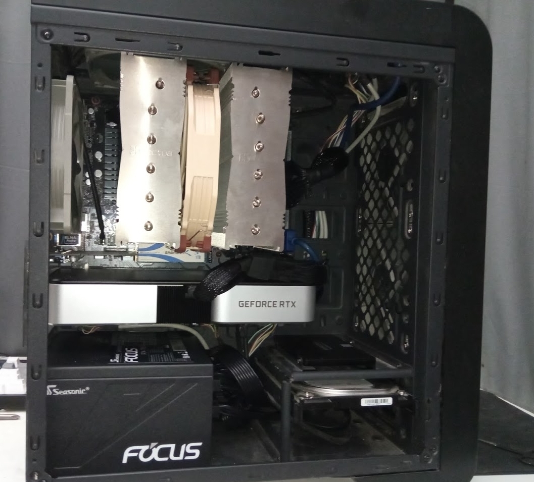

With an RTX 3060 Ti FE and a Seasonic PX-750 I now genuinely can't hear at all it even under load with my ambient sound level.

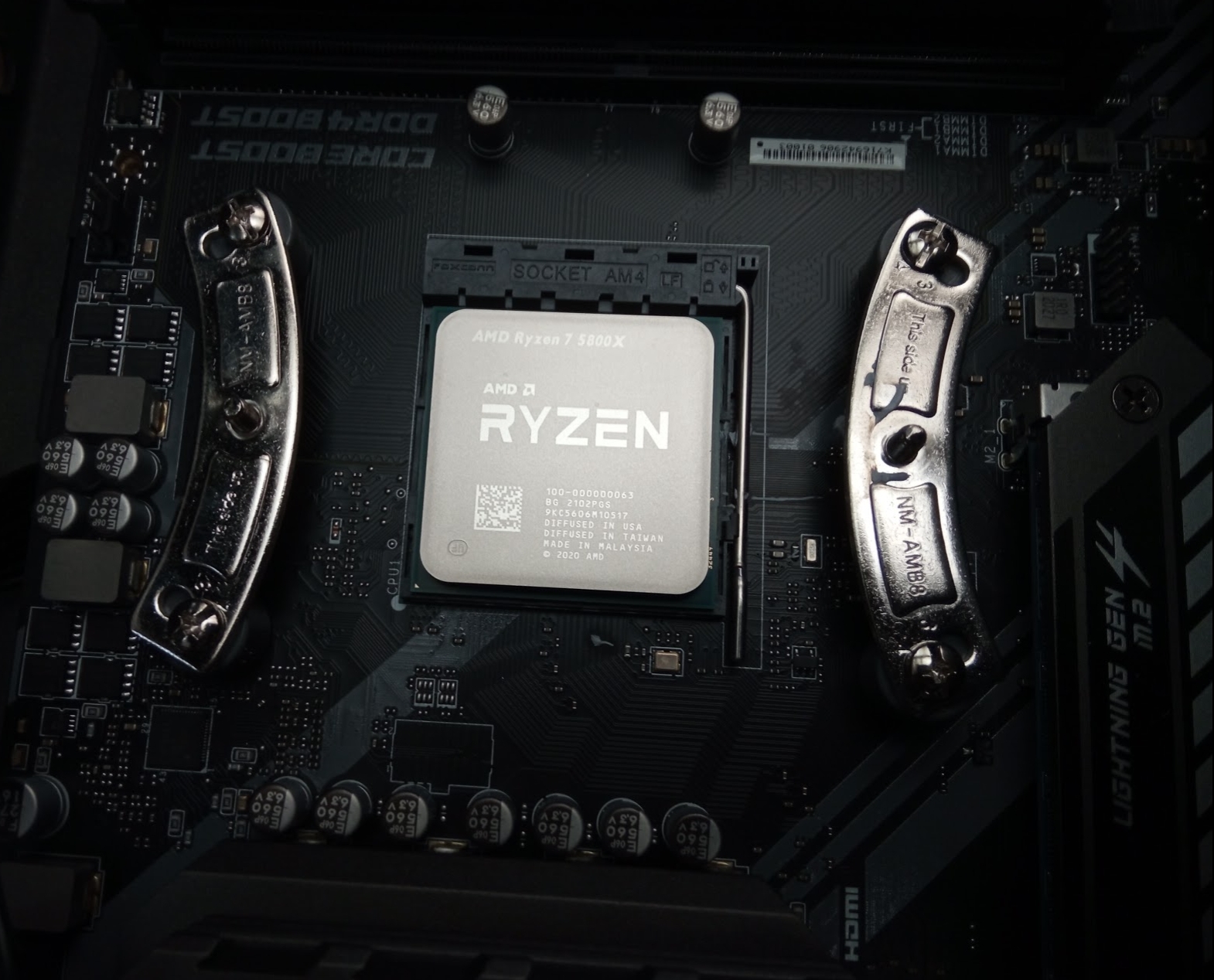

This little rig has come a long way in 2 years, from its FX8320/HD7870XT origins, these are hopefully the last two major upgrades in a while, no longer for silence but for speed, motherboard started playing up a little (ASRock B450M Pro4) so decided to replace it ASAP as I couldn't take any down time, went with the MSI MAG B550M Bazooka.
Despite official claims to the contrary, the old 1600AF CPU worked fine in this B550 board, apparently consistent with other MSI B550 boards. However I wanted a step up anyway, so with it I've got a 5800X too.
