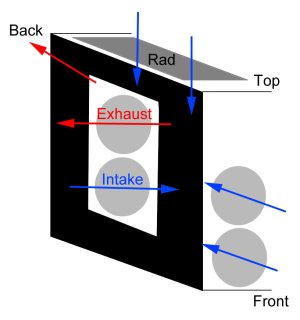

I would like to know if it makes any sense to set 2 side fans in different orientation or is it better to have them both in the same direction.
I am thinking to have one fan for intake of cool air and one fan for exhaust of hot air. These 2 fans are just on top of the 2 video cards.
I added a scheme to make it more clear... I am also planning to add another intake fan on the bottom of the case.

I have a feeling you will start to create a cycle where the air becomes trapped in a circular flow (anticlockwise in this picture) just going round and round. So I would say keep them both as intake.
To balance intake and Exhaust I would therefore configure it as sides intake, front intake, back and top exhaust. That should create a resultant flow direction of bottom/front to top/rear.

I have your exact setup in a corsair 600T. The side fans (intake bottom and extract top) really helped my top GPU card temps, from memory I believe there was a 5 degree drop with the side fans on vs off.
Did you try other configurations other than that? I would be very surprised (but also interested) if it performed better with two opposing flows rather than one single direction.
Top side fan as intake and bottom side fan as exhaust. You want the GPU's heat out of your case the fastest route possible. The CPU on the other hand will need a lot more airflow as it will usually have larger fin stacks. Everything else is fine.
