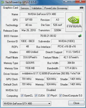

Also i have noticed that the Subvendor is NVIDIA in gpu-z and normally it says eg. XFX, EVGA, ASUS GIGABYTE ECT ECT What i was to know is how could i tell if this is an engineering sample or a prerelese as i have never had this in gpu-z befor and i downloaded it today so not using an old version its the latest. hear is a screen shot or GPU-Z
Tell me what ya think guys and tell mw how i can overcome this, also i have noticed that the frame rates are not much diffrent then my 9800gt about 10fps more maybe in battlefield bad company 2 with everything maxed out obvious the 9800gt is only 8 or 16x AA and AF whear as i was using 32x AA and 16x AF and using 1080p res. And the biggest flaw is the heat OMG 99c in crysis system was starting to crash and had to force it to close. tell me what ya think guys. Thanks John​

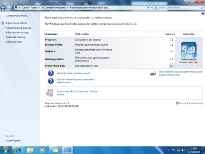

yeah i do and made no diffrence at all i could not be a power issue with the card as 1 im using a corsair hx1000 and 2 is it will play games also, just thinking it could be because the gpu its new tech and and the system is about 3-4 years old so might not be equiped to cope with it, also my wei score is odd but this might be due to motherboard bandwith issues, what i need is someone with a good system to test this card and see but none of my mates are into computers like i am lol so im stuffed on that 1 lol. any more thoughts ill try and get pics of inside the system but lack of digicam so ill do it when i can get.

yeah i did use driver cleaner in loaded new drivers in safe mode and also have just updated bios also and still now joy thats anyway bro AND.... I have only just found out even tho my motherboard has a lifetime warrentee with EVGA it is void because it was brought from ebay. so whats the point of saying lifetime warrentee on your porduct if they dont actually hold there promise? Anyway i have tried and tried but no joy i have gamed with it as you just have to wait for windows to load then it shows graphics on the desktop. Ideally i might take it to a pc shop and get them to test it out and bench it for me but another thing that is really bugging me is that the subvendor or the card is NVIDIA so i might actually take it apart and see if its a engineering sample and if so i will land the seller in the doo doo. As NVIDIA actually own them no matter what and ill get the guy banned as these should not sell and no discription what so ever was mentioned. So if no joy at pc shop tomoz then im gonna take the hsf off and look at the chip. and ill post pics if it is a sample keep up with ideas
