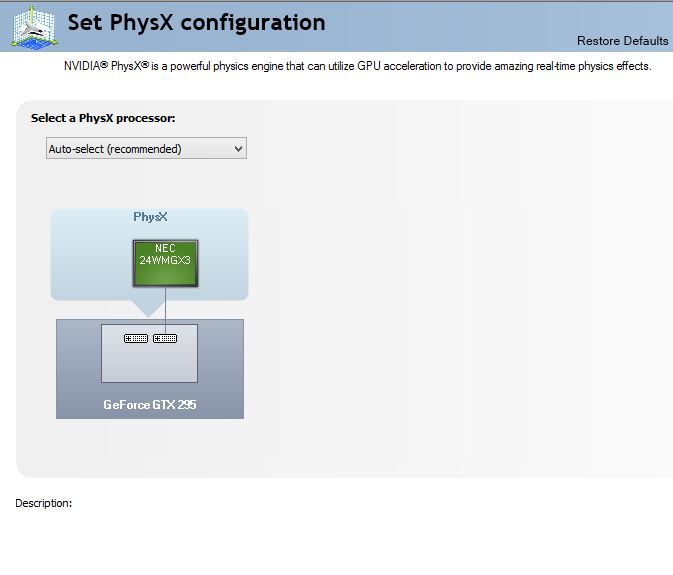

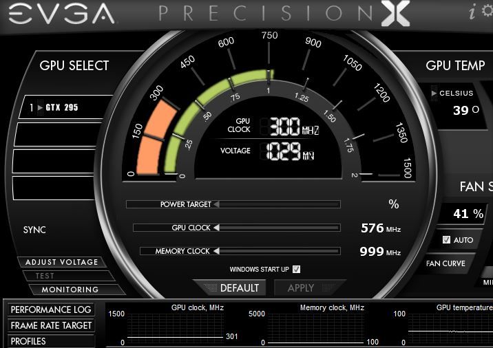

I noticed the Blue LED was not on (Blue LED indicates the main gpu is on, the one with HDMI). So I disassembled the GPU and checked the sli cable; it was thoroughly attached. Some good news is that the Blue LED is back after assembling it again, but I still dont have a signal from HDMI. Programs such as Nvidia Control Panel and Precision X is also only showing 1 GPU.
Nvidia Control Panel not showing the HDMI output
Precision X only showing 1 GPU
