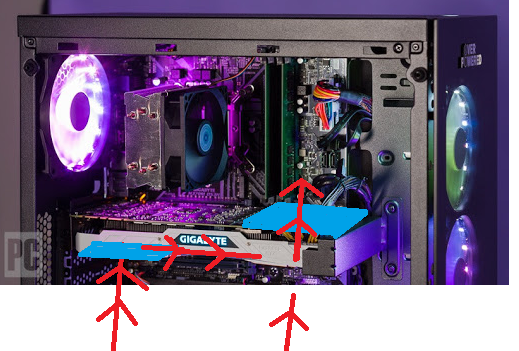

Going from the orientation of those fans and the slot looks like it would work like this.
(Fans are the blue squares, airflow the red arrows, one of the fans would both intake and exhaust as the other side is vented)
The left side fan cools the GPU core chamber, and from what I can see will push that heat straight out of the PCI plate. The red line indicates where the back of the case will be.
The right side fan seems to be for the fets and memory, and looks like it will either exhaust out of the other end (as I have indicated with the yellow scribbles)
So the fan on the right is an intake, not an outlet.
As I said man, it's a proper puzzle this one !

The other fan is hidden. Look at the design and they are not on the same horizontal level. Looks like on is intake and other exhaust
Its the opposite in my opinion. Looking at the visible fan design we can only assume it turns clockwise so it acts as intake, other wise the fans would need to be flipped if the rotation was the other way. Also the orientation of the PCI slot means this fan is face up. It has to intake the cool air blowing in from the front, and exhaust it out the bottom.

This is how I see it. I don't think there can be airflow between the two fans due to the orientation of the heatsink fins.
Edit: The airflow on either fan could be reversed. Can't really tell from the picture
Edit 2: The airflow on the top fan is probably reversed so that they both blow upwards
