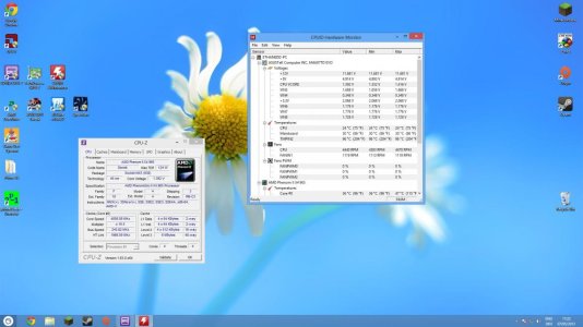

But i''ve now got another q, annoyingly it seems that my CPU temp reader doesn't seem to want to move with the Core Temps ?
stayed at 24c while the cores went up to 47c
But thanks for the help guys, so simple when you know what you're doing i guess

Had a fiddle and now trying to push it up to 4.1, pushed the voltage up by one notch (Currently at 1.453125) and i'm now getting an error on the 4th core.
"Rounding was -.462890625, expected less than 0.4"
Do i just need to push the V up a bit ?
