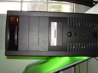

Picked up a cheapy Ex-Display case while emergency shopping in pc world the other day for £25 with some modding in-mind. so far ive sprayed and glossed two drive flaps and added a window.story so far (click for bigger images):
Early stages with one drive flap and siver floppy :/

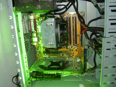

Fairly spacious inside

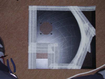

All masked off ready for the jigsaw

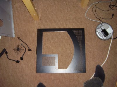

Cut and ready to go

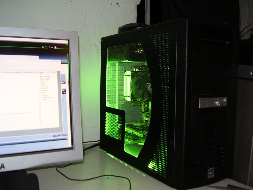

Finished window:

Turned out dam fine. Can i have my jigsaw blades back now?

What did you use for the cutting?
yea just high teeth-per-inch blade, preferable with as little paint on as possible as the heat can make that rub off. and have one or two extra as aluminium like to clog blades up something fierce
ta mate...better to use a jigsaw for those non-circular cuts than a dremel/holesaw?? I ask becauase I'll be hacking my eclipse 62 case top next week to fit my thermochill FG120.2 fangrill and PA120.2 radiator..

yes is the sense that you have a footplate on it that you can use as a guide, nevertheless, getting a straight line is not easy so have a file ready :) umm, make sure you mask off all the area that you want to keep to prevent scratching (use a 24hr+ masking tape) . Depending on the paint finish on the case it might be best to cut the plate from the back as jig blades cut on the upstroke. what else.....umm.... use a half inch drillbit on each inward corner, with the edges of the hole touching the cut line (this helps with rounded edges and getting the cut started) and make sure you build up to the 1/2" with about 3 bits ascending in size :)
