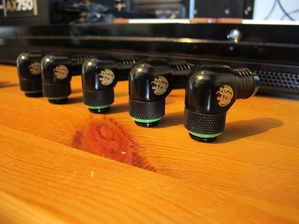

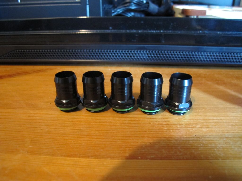

Go with bitspower matt black fittings. Ive got them too and they look very nice. And should be in stock almost everywhere (over here atleast).

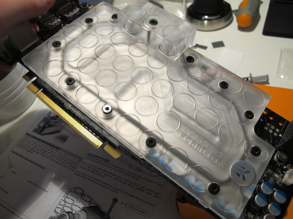

Since youre doing it mostly for looks, I'dd go with blocks from the same company. It will look better when its all in the same style.
And as far as for SLI fittings, get a bridge. I think that looks beastly. Im not a watercooling pro, but recently did my own build. But I like the Ek waterblocks very much. It just looks super slick. Shouldnt be that hard to find out the spacing? Atleast with EK blocks theres always 1 card every 2 slots. Due to the 90 degree block you can put on it and which is needed for a bridge.

The 120mm wasn't for the cooling as much has just for having something there, not even 100% it'll fit though so might have to lose it. I did consider bitspower fittings, but they are 2-3 times the price of everything else and have no 16/10 90 degree anyway. I would rather go 13/10 and have 45+90 alphacool fittings than spend £15 per 45 and 90 bitspower fitting.
As for SLI Bridge there isn't one for komodo which covers my PCI-E layout, I have two empty slots between them and on swiftech site they recommend using adjustable CF fittings for that situation. I'll rather not use EK CSQ stuff either, especially on GPU as the stock HD 7900 design isn't full cover in the way the komodo or lightning/680 blocks are.
Matching blocks would mean using Drive II as well, it's the only swiftech cpu block with the same design as the komodo's. I did consider using it + 480mm but was unsure about it due to not having a res high enough to feed it.
