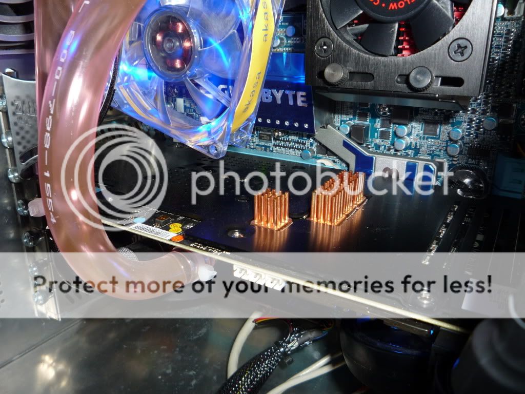

The x58 is a hot chip at the end of the day. If your worried about the temps, you could change the TIM, which ASUS unofficially suggested for the 790i ultra boards, and probably won't void the warranty. Alternatively, position a fan so that it is blowing across the motherboard.
80C seems a bit high, but then again that is under prime stress, so ordinarily it shouldn't get too hot. Check that whilst gaming it doesn't get too hot from convection from the GPUs but don't sweat it too much, I doubt that it is that heat sensitive.
Idle around 55'C without fan 60'C on load.
With fan it never goes over 50'C.
Im running a 200MHz BCLK which requires addition NB voltage too.
Is the NB heatsink hot to the touch? If not then it suggests that it is not in contact with the NB itself.
