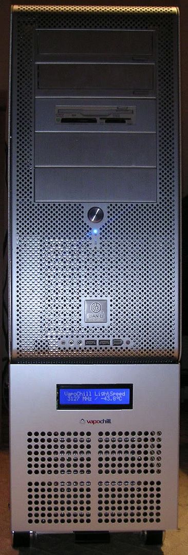

You can get the V1k series to work ok, you just have to do a bit more modding than usual, cut 2 holes for the evap and make sure that you have a motherboard where the socket is reasonably close to the top of the motherboard.
Proof is in the pic, so it can be done if you want to:
