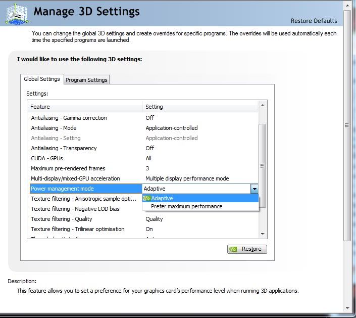

It's to do with adaptive performance. The reason that these cards were slated on release (the 470/80) for their temps was mostly down to the fact that when you installed the driver the clocks speeds were 100% at all times. So, with them like that my card will idle @ 66c and max out at 79c.
ATI were obviously quite crafty and shrewd with this. As we know, the 5 series downclock dramatically when not being used. So, Nvidia came up with this little ditty..
If you select prefer maximum performance then the card will always be at the solid clocks on the bios. If you select adaptive it downclocks when idle and not in use to keep temps down. Most of the 'issues' with GF100 were down to the drivers Tom. I mean sure, the coolers were utter gash too which didn't help but that's why when you tame up a 4xx the temps fly down.
There is an adaptive setting for multiple monitors however it doesn't seem to work. Whether this can be resolved with a driver update or whether it just has to be like that? not sure ATM. It really shouldn't matter to me soon as I have two options of getting out of it.
