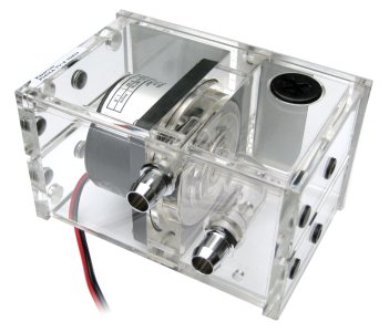

im trying to figure out if the Mayhems Aurora coolent will work in the XSPC Dual 5.25" Reservoir for One Laing D5 Single Loop. i know the horzontal one dosent but what about this vertical version???

I imagine that the Aurora will collect in the bottom of the reservoir over time due to how the pumps inlet is configured.
In a normal setup the reservoir would feed in to the pump with the liquid entering the reservoir from any side without thought. But in this reservoir the liquid entering is funnelled directly in to the pumps inlet so a lot of the reservoirs fluid I imagine would just swirl around and not go anywhere. Obviously this is just my opinion and thoughts on it. I'm not a liquid dynamics expert by any measure
I'm sure Mayhem will comment on this and give you a definitive answer.

Dont use Aurora for long term use this is all so stated on the site and on the bottles. use pastel / X1 or water + ecocide instead.
