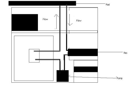

is this better
how are you going to fill the loop with the pump in that position? i would suggest you have the pump at the bottom of the case

its best to have the pump at the bottom of the case so it will be easier to prime and bleed. but having the pump at the top, middle or bottom will not effect the performance of the loop.

i suggest to go for the first design you had before......as i always think Rad > Res > Pump > Block is better.....because......the only thing in my loop that push water around is the pump, and the pump should get 'cooler' water first so it last a bit longer (thats what i think......)
The loop in your first post is fine mate, but you will have issues filling/bleeding it with your res where it is. Personally I'd eliminate the res and use a 'T'.

from the water cooled systems i have previously built there are just a few rules I follow.
Resevoir to pump and the pump has to be below the res. doesnt matter where it is in relation to the rest of the kit but below the res for priming as has been mentioned already.
I always put the cpu block next because some blocks require high flow for best cooling.
but this really means that the rest of the system will be cpu block to rad and rad to res.
hope it helps
Even though it's a closed loop, I would still put the pump below the res/T-line. Most common pumps used in watercooling are not self-priming, so having the pump 'gravity fed' makes it much easier to fill the loop with water. Apart from that your layout looks good. :)
