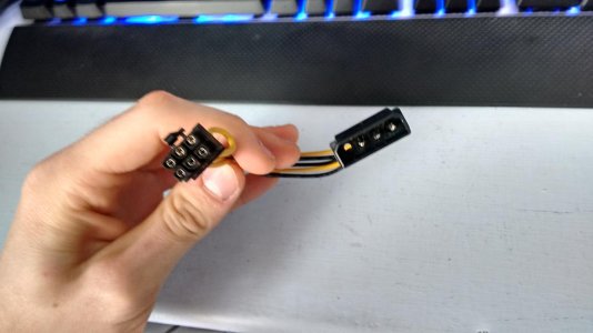

The attached image is the actual cable that came with the card. It has just one

From what I've read you should use two molex to one 6pin like in the example I showed above so you have 6 total pins (3 pins per connector) in molex to the 6 pins in the GPU connector.
But if that adaptor came with the GPU I assume it's safe to use it, however I'd try to get my hands on the other type of adaptor just to be on the safe side.
So I need one of the adapters that you linked to me and then plug that into the whatever pin to molex that came with the psu?
Whats frowned upon is using molex to 6 pin. Also I'm not entirely sure if mixed crossfire is still a thing.
Yes. Also the each molex connector from that should be connected to a different molex cable from the PSU. I see you have 2 cables for molex/peripherals.
