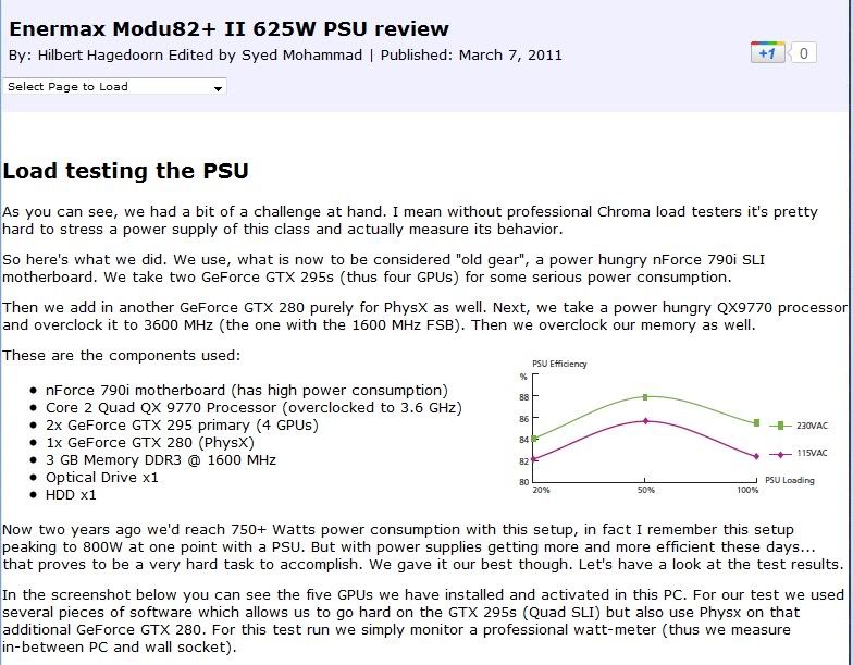

Go here.
http://www.guru3d.com/article/enermax-modu82-ii-625w-psu-review/6
Or if you can't be bothered here, look at this.
It.Isn't.About.Wattage.
That's a smoke screen. It's about ampage. Car amplifiers draw 13.8v no matter if they have a 20w output or 2000w output .It's the amps they draw. A large amp can suck dead an alternator and battery in minutes.
Please, go away and learn how electricity works, ohms law, waste heat and how the 80+ org rating works.

I don't think any more than 650-700w is needed for GTX 560 sli, most due to what was said in that article.
The reality is very interesting, where we passed 750W two years ago with all that equipment and overclock we are barely able to pass ~700 Watts load.
Now mind you, this is a 625W PSU, with an allowed peak to 690W. It however was not an issue.
As stated, a year or two ago with this very system we'd have passed 800 Watts. PSUs themselves are becoming more and more efficient and thus greener as well, in the end saving on overall power draw from the wall socket, and that in return saves you money on the power bill.
