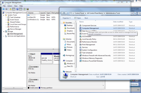

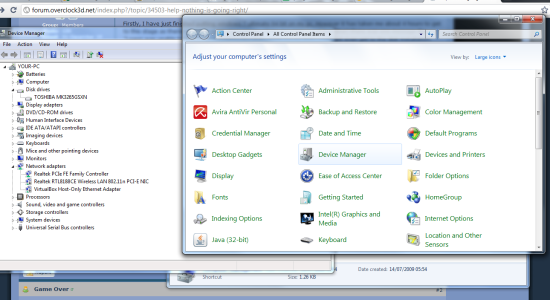

HDD's not there. I've hopefully attached 2 pictures. Help 1 shows you how to get to device manager. Hopefully you should see the drives here.
You should then go to computer management (if your unsure where these are just look at the address at the top of the windows I left open and follow them. Once you've opened up the computer management you should go to storage and look for the drives. I think you should just need to format them so they show up but if there not there I'm not sure what's wrong.
If you want to use raid I THINK (although not sure cus I haven't used raid) you should set these up in your bios first so they look like only one drive in windows and then format them but really not sure on this. certainly go look for them there in computer management. If there they than they just need formatting. If there not I'm afraid I'm not sure whats wrong atm.

To get the HDD's working you use the Manager section that Karlos put a pic of. You can get there also by right-clicking on 'computer' in the start menu, then click 'manage' and navigate to 'disk management'. There at the lower section right'click on your drive and 'initialise' it and 'create simple volume', give it a drive letter, format etc. I think that's what to do.?. I haven't done a standard RAID setup and I don't know about that.
