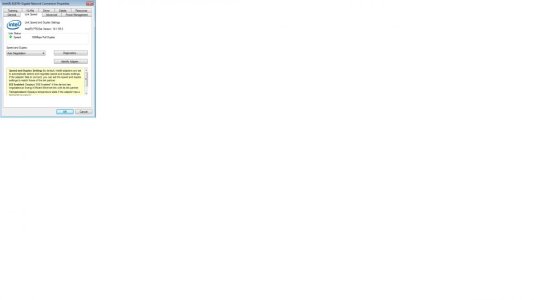

I bought 200 mb internet and the max speed test i can get in 93mb then i saw that my Ethernet card is set to auto at 100mb is that normal

sorry for bad pic , rampage 4 extreme-Intel(r) 82579v and yes to the new router

Alright, you need to go to the network and sharing center click on the left where it says adapter settings you then right click on the ethernet adapter and click properties then in the new window you click on configure. Go to the advanced tab, there's a field called speed & duplex change the value there to the highest
i check the cable is say cat 6 on it , i also change the duplex to 1 gb and it cut out my internet and says not supported
Hmmm.. is the cable connected into port1 of the router? i would also check the speed rating of the router to make sure it supports 1gbit (i imagine it should being a new one) only other thing i can suggest is testing it with another ethernet cable as the one you are using could be dodgy.. process of elimination
The ethernet adapter should auto detect
