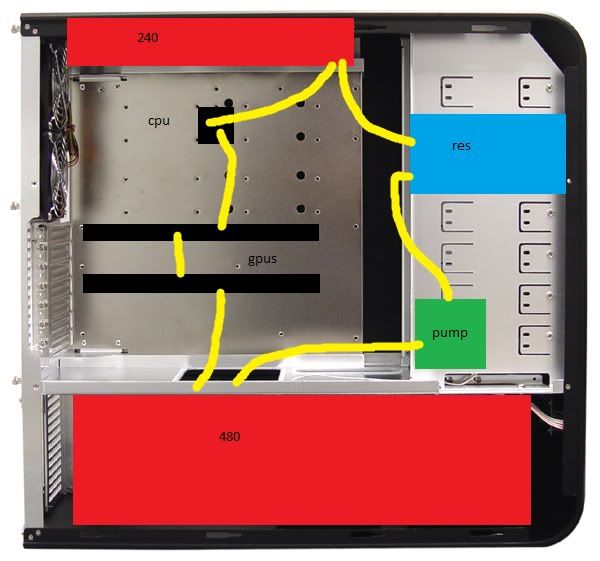

i would say that your configuration looks pretty good, but some pointers (well more like my personal input
1. Do one loop, having two loops will create a lot more tubing and ur going to lose 2-3C max, so i don't think its worth it. Go for the cleanest look with the least amount of hose possible (this means dry fitting and testing out to see what works best for ur components, just don't rush and it'll turn out amazing.
2. i looked at the tj07 and if your using a dual bay res, and a 480 in the bottom i'm assuming the 240 is in the roof right?? well assuming that i would go with the following configure:
RES - PUMP - RAD(bottom 480) - GPU - GPU - CPU - RAD(top 240) - (back to )RES
now i'll let the WCing pro's correct me, but i think that will be a super clean loop and considering that the 2600k isn't as hot as the bigger chips (lga 1366/2011) and that the 570 aren't that hot either (not 580 or 400 series) i think ur temps will be just fine.
p.s. if i'm interpreting ur loop order wrong draw something in paint over a pic of the tj07 and show me
-if i don't forget i'll try to add that for fun

@mrDMxtreme
Agreed on the single loop, that’s what I ideally wanted.
I’ve not got any of the WC kit yet but have my eye on a single bay RES so it would leave room for a 240 in the front (just)
I like your idea of the RAD before it goes back into the RES too, what are the effects of going through the GPU’s first, going to have on the CPU temps (if anything)
My doodles to follow.

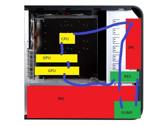

@grandpatzer
I’m hoping to also put the pump into the bottom so I’m hoping to get away with the thinner RAD but a 60 would go in with some effort but maybe only in push or pull but I doubt both would fit, mind you .5c isn’t a huge deal.
The plans/ideas i had were these two but I was assuming it would be best to have CPU before GPU and also having the RADS after the pump
or
Going on what grandpatzer said about just having just the 480 and running through the GPU's first I thought something like this?
think of it this way, the water in a loop is moving around very very fast, so the temp of the water itself is going to be almost the same so the order doesn't matter too much. that said the cpu temps are known to be the hottest thing in a loop so don't worry its not the loop order if you see the cpu a bit hotter then the gpu's
you will be fine with the rads you have but put them in 1 loop, i have both the 2600k @ 4.8ghz and 570 @ 904mhz in one loop with a dual 360mm rad and a dual 240mm rad after hours of folding cpu temp = ~ 60c and GPU temp = ~ 43c which is very good reults considering the mad OC i have on my GPU and CPU!!!! so an extra 570 shouldn't change anything plus you will have an extra 120mm radiator cooling capacity!!! so all gooood
