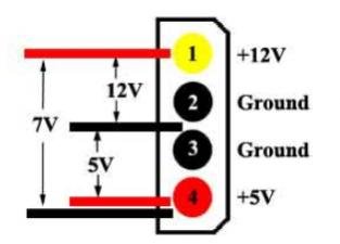

I recomend that you buy something like a 7v fan adapter or making yourself one, using this scheme!Captura.jpg
I imagine that the fans are installed in slots with contact conections so you have to take off the adapter that makes the connection and make the wires longer and connect the fans to the PSu using the scheme!

No disprespect JMMP but you need to know what you're talking about before making suggestions for 7volt mods. Fans on these devices don't run molex connectors they run proprietary 6 pins if you put the fan on 7 volts the BMC will detect the fans as failed and either shutdown or alarm like crazy. (They do a full volt range test on power up 0-12 to check fan health)

......No disprespect JMMP but you need to know what you're talking about before making suggestions for 7volt mods. Fans on these devices don't run molex connectors they run proprietary 6 pins if you put the fan on 7 volts the BMC will detect the fans as failed and either shutdown or alarm like crazy. (They do a full volt range test on power up 0-12 to check fan health).....
Hi lee,
i know what i´m talking about but i forgot that point!! thanks for the correction!:)
