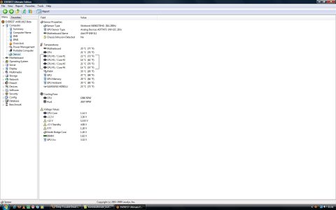

Just noticed these temp irregularities on everest for my quad. Is this normal or does my heat sink need adjusted ?
Cheers, sprento.

Yeah the temps all go up in prime95 but there is still a difference between the 2 core pairs, by about 7-8 C. it's a Q6600 at stock
Hmm then it isn't a stuck sensor.
I'd try a cooler remount with decent thermal paste if you haven't used so already. Which cooler are you using?
I'm using a Freezer Xtreme with mx2 paste. When I first got the cooler I threw the plastic pins as far away as I could and secured the mounting bracket with an old 775 back plate from my old Alpine 7. Also, the screws that are supplied for holding the cooler to the bracket were too short so I replaced them as well.
