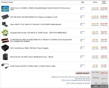

hi, I want to build a budget gaming rig <£600. I want to know every single (everything) part ill need to build this rig. Here is what I have so far:
Processor : i5-2500k@3.3GHz
Graphics Card : XFX HD 6870 1GB GDDR5
Motherboard : ASUS P8Z77-v DDR3 MOTHERBOARD
HDD : Seagate Barracuda 1TB SATA-II 32MB CACHE-OEM
RAM : RIPJAW 8GB (2X4GB) DDR3 1333MHZ
PSU : OCZ CoreXtreme 500w '80 plus' PSU
CASE : Aerocool Vs-4w Midi-Tower Windowed Case
Cost=£594.89
I want to know if its good or if I can make it better. (OS not needed)
Your help is greatly appreciated!^_^

Lose the plug, that'll save you a couple of quid ;)
Also, I wouldn't go near an OCZ PSU - or anything from OCZ for that matter. I'm just heading home, so if no-one else has some up with anything in about an hour, I'll put something together :)
Based on your current spec: Try and bump up to a 3570k if you can and get an MSI Z77a-G45.
As said go for a Corsair psu over OCZ.
Now - what I'd do...
Drop to an i3, again MSI Z77-G45 (or wait for Ivybridge i3s) and try and squeeze out a 7850 out of the budget.

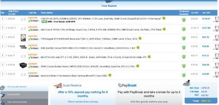

i just checked the cost on scan.co.uk and its £557.44. Not exactly the same but close
-Intel Core i5 3570K,1155, Ivy Bridge, Quad Core, 3.4GHz, 5 GT/s DMI, 650MHz GPU, 6MB Smart Cache, 34x Ratio, 77W, Retail
-1GB XFX HD 6870, 4200MHz GDDR5, GPU 900MHz, 1120 Cores, EyeFinity, HDMI/ 2x mini DisplayPort/ 2x DVI-I +Free Nexuiz*
-1TB Seagate ST31000524AS Barracuda 7200.12, SATA 6Gb/s, 7200rpm, 32MB Cache, 8.5ms, NCQ
-8GB (2x4GB) Corsair DDR3 XMS3, PC3-10600 (1333), Non-ECC Unbuffered, CAS 9-9-9-24, 1.50V
-MSI Z77A-G45, Intel Z77, S 1155, DDR3, SATA III - 6Gb/s, SATA RAID, PCIe 3.0 (x16), D-Sub/ DVI-D/ HDMI, ATX
-500W Corsair Builder Series CMPSU-500CXV2UK, 80% Eff', Uncertified, Quiet Fan, ATX v2.3, PSU
-AeroCool Strike-X One Advance Black Gaming Micro/ATX Case USB3
You'd be surprised what you can get for ~£600.
That case is only there as it's of similar price to the one you chose.
But yeah...a 7950. Ooft.
P.S. I can't read your thumbnails at all :(
I'd go for the cheapest. Or, wait until Ivy.
Another alternative:
Overclock that little CPU and it shall outperform the i3s.
For an i3 you wouldn't need an aftermarket cooler to be honest, as you can't overclock it etc. The stock cooler can get a little loud, though, so it may be a good idea.
To overclock the AMD solution, you would indeed need a cooler. Note the one I included.
