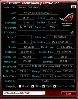

I need help badly, I bought a new GPU and was going to sell my old one. New GPU is Asus GTX560 ti 1GB GDDR5 with SLIGHT overclock of 830MHz.
The 3DMark11 score I SHOULD be getting is around P4000~P4200 for Graphics...but its more like P3688 which is as high as my overclocked GTX460 768MB, that is a nightmare! I checked my Bios made sure everything is as it should be, made sure nothing else was running in the background etc etc...start the test and get the same performance, my PSU is still the Corsair 600W don't know if power could be bringing my cards perfomance down or not. I am also running the latest nvidia drivers 270.61. Does this mean my Graphics card is faulty or is it something else?

Ok I will try that...btw don't know if this means anything...but when I first put the card in it took very long for the OS to recognise it and even then after the restart something didn't look right. I got some weird error and then it dissappeared. But since then I've restarted about 3 times already and get no erros or anything but i still get the same performance. But I think I should try uninstalling all drivers and re-installing them again just incase.
That sounds a bit weired, it should just work strait off. Were you using a AMD card before this one? if you were that might cause some problems if the AMD drivers didn't uninstall fully. Try taking it out give the connectors a wipe and make sure it's installed correctly and try again and if you still have probs uninstall all drivers and try an old one first to see if it is the drivers. Apart from that I can't think of anything else.

Hey guys thanks a lot for all your help SieB you helped a HELL of a lot telling me to check my drivers...it was my drivers I had 3 of the same driver running together lol.
Uninstalled all drivers and re-installed everything worked fine I was getting very similar scores to Ian88 after I fixed everything up. Thanks a lot for sharing your scores dude they helped me! Btw Ian88 awesome system man...epic OC on your CPU lol.
