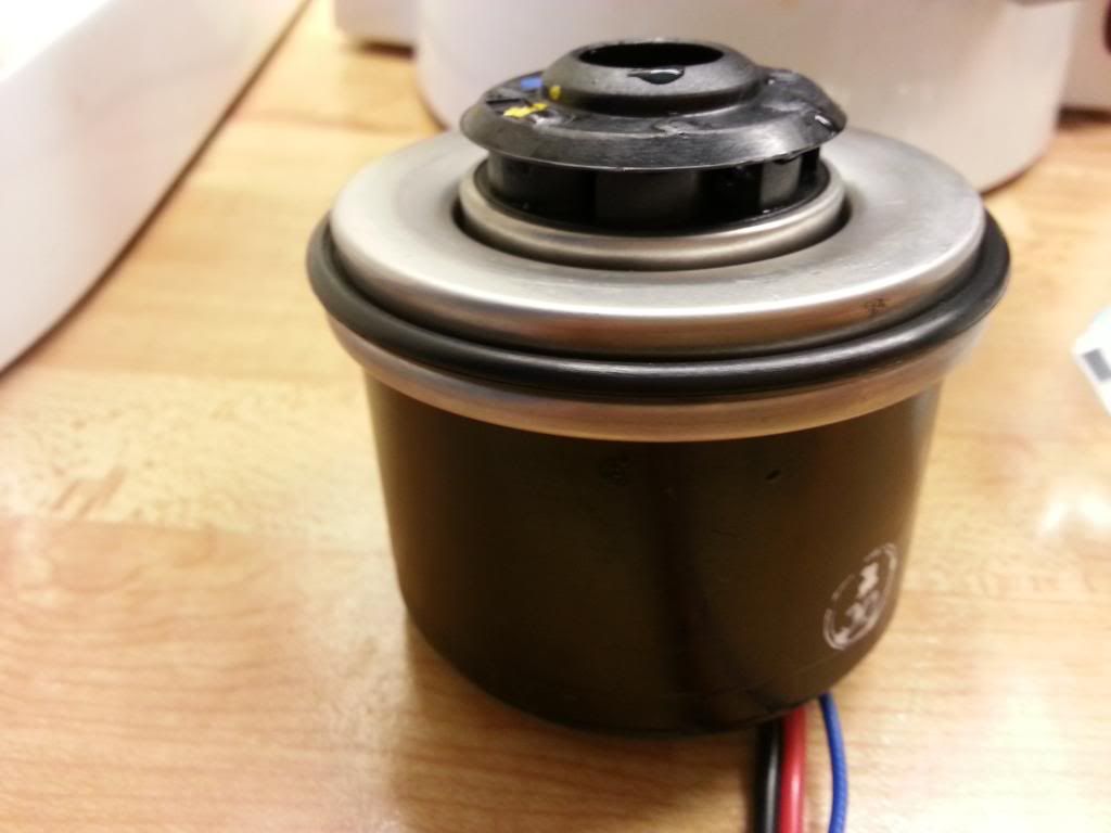

Is the O-Ring in the right place ? You might aswell check for some kind of debris that makes the ring sit wrong. On the second pic you posted, if i am correst the o-ring is not in the right place (should be on the right side of the top junction)

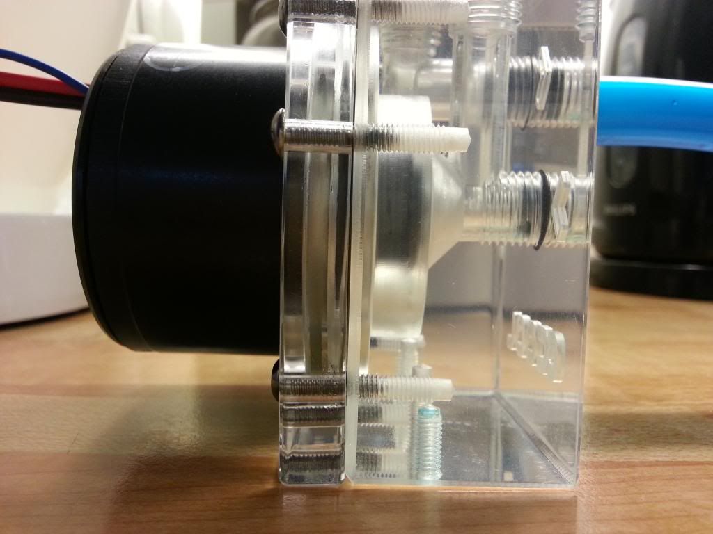

Also some pics from the side of the unit could help
i disassembled the top. This is how the O ring is sitting:
And this is how it looks from the side:
and i'm pretty sure there are no cracks.
