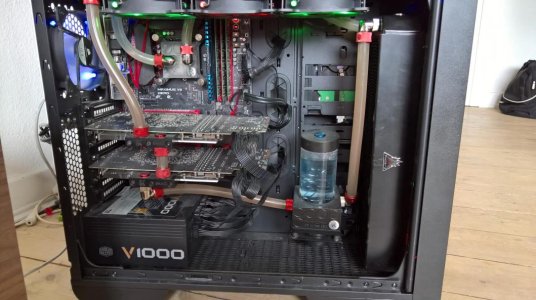

Hi guys.
i've just cleaned my wc loop and now my I7 4790K @ 4.7 ghz : 1.3v.
im getting 75 C. under load when gaming. its that normal?
before cleaning my wc loop i thought that it hits so high temps because i need the "insertpin and the jet plate" so i did put both of them back in the CPU block.
now that i've cleaned my wc loop and now my I7 4790K @ 4.7 ghz : 1.3v.
im still get 75 C.
my setup:
2x 360 rads
EK supremecy evo
2x Asus matrix 290x
d5 pump
250 cylinder
ill put a before picture of my setup and after.
the one after has white hoses.
couldnt upload the new setup, here it is. :D
http://imgur.com/juWLHVJ

That setup depending on fan speeds and graphics overclock yeah I would say that's about right when gaming. The 290x is a very hot card so 2 of them and your cpu all under heavy load can easily push your temps up.
I would actually say that 75 degrees isn't that bad at all with that setup

A 295X2 is easily cooled with a 240mm rad so the 290s are dealt with one 360, the second one should benefit even more so your cpu shouldn't get that hot. Check for air in your block. Maybe there is some in your rad too.

my 2 290x doont even go up more than 36 C under load. My cpu is my main concern. :(

i cleaned my loop for about 2 hours with vinigar acid. the rads are clean. after rinsing 3 times. no filth came out. no algie or other nasty stuf.

The Corsair SP fans are fine. Your temps are pretty much Normal. The devils Canyon series had an improved heatspreader. However its still not as good as the SB.
As for the GPUs. Are you talking about load temps here? If so then there may actually be a problem with the CPU coolng/block etc if your ambient temps are low enough to help cool the cards that well under load.

1.3V through a CPU with a still relatively poor thermal interface is going to result in quite high temps. I don't think you will gain much through changing the fans, to run high overclocks at low temps then a delid and repaste could make all the difference. The loop seems appropriately specced for the heat load.
Are your SP120's quiet edition or performance edition. Something like a Noctua F12 or EK Vardar may net you a tiny a bit more airflow at a lower noise level but the SP120's are suitable for the application even at low speeds.
