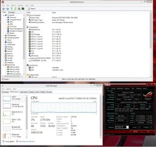

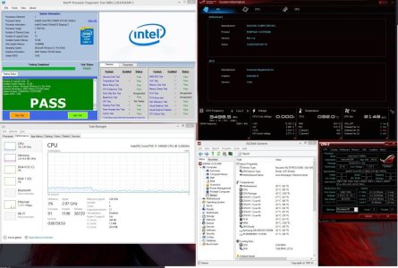

Here is my problem i seem to be missing 2 cores on my 5960X.Now the rig runs fine, but everything from Task Manager to Intel own processor test show 6 cores 12 threads. Motherboard is a Rampage V Extreme Bios version 1302. Out of all the forums out there, i though i would come here for advice. Thank you fellas. :D

First thing that comes into mind is: Have you checked if any of the cpu socket pins are bent or broken off? Might need a loop to check.
Ok, any chance 2 of the cores are disabled in the bios?
I updated the bios to 1401 a minute ago,everything is at default. Still showing me 6 cores 12 threads even in a Cinebench run. My old score back in October shows 8 core 16 threads.

Hmm....In the UEFI it shows all 8 cores are enabled,also in device manager it shows all 16 Logical Cores.

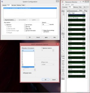

do you have boot.ini set to use all cores/memory?
in run type msconfig.exe
under boot tab
select os, and click advanced
select maximum number of cpu cores to 16 or w/e
reboot.
if it doesnt work, what is perfmon showing, any cores parked?

Navigate: Run>msconfig>boot tab>Advance options.
See if it is allowed to run all cores. Or alternatively tick the number of processors option and select 16.

did you get around to checking msconfig?
Here you go. Things that make ya go hmmm..... Easy way out would be to clone original Drive,but then i would never find the culprit. So tempting.

that's a really strange one, since it worked with a different os it would lead me to believe it is either driver(only if you had a different cpu in [with same os] before) or its just kernel not having it.
what happens in safemode?
Tried it in safe mode,and got the same thing. I then ran sfc scannow,and came up with corrupted files( but was unable to fix) . So i took the easy way out,and re-cloned the original C drive. All is well now. Thank you all for the help,appreciate it so much.
