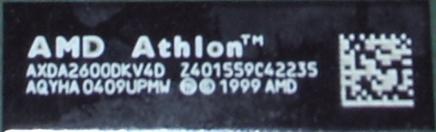

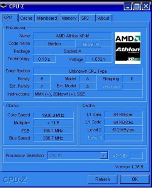

The other day I ulocked my L5 #2 bridge with some powdered graphite and CPUZ Identified the chip as a mobile :) , Unfortunatly the motherboard didn't recognise this and my multipler stayed locked at 11.5. :mad:

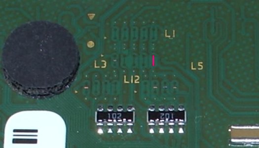

Now, i've looked around and from what I can find the deal is I need to bridge the L3 to unlock the multiplier, but I've seen conflicting info here. Some say this unlocks multipiers below 11.5 and some say this unlocks multipliers upto 13. Also the bridge that they say to join up appears as if it is already joined. :confused:
Now I know this is old hat to most, and I appologise for that, but I have to ask if I bridge this connection, (marked in red in the attatchment) will I be able to raise th multiplier above 11.5?

well really, your multiplier should be unocked from 11.5 downwards anyway, so if you cannot select a multi of 9 for example, then it seems your mobo may not let you change the multiplier.
have a look in your mobo manual and see if it allows you to change this option in bios. (not just look at it, change it)

Finally got round to doing the wire mod. used some wire out of an old IDE cable I had lying around.
Followed the instructions in the link above, Setup in my bios to run 166FSBx13Multi...no joy?!
The pic of the wire mod is attached, when this didn't work, I tried to tighten the loop up a bit more...It broke :eek: !!!!
No problems I thought, just do it again... :rolleyes:
Did it again, tightened it up, banged it on the desk a few times to make sure it was tight enough:crazy:....All Good, tighten a bit more...Sweet!!
! We're gonna rock'n'roll this time I thought.... reinstalled :o
Still no joy!!!, WTF???
Check the wire again, right spot according to Tom's, making good contact, as good as it can get without snapping a pin or soldering it
Still no good. :(
So what can I do???
:damn: :eh: :banghead:
