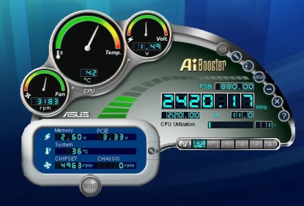

Currently, looking at AI Booster. All the needles are in the green. That's fan speed, voltage and temperature.
Checkout the screenshot below, the temperature concerns me. Another couple of degrees and we'll be in the yellow.
Note: You might notice the chassis fan readout is nil, but I have two fans in this case - they just aren't plugged into the motherboard is all.
Lol 42 is nothing. I have a Venice 3500+ and i am idling at 43 right now and i have a CNPS 9500. Also, as long as you dont up the volts then the temp. will not rise that much.
I have a Venice 3000+ @ 2.43ghz idling at 32C and load about 45C. I have a stock heatsink. I would say under load no higher then 50C just to be safe.
So continue tweaking and stop when I get to 48-50 under load?
I set my CPU fan to go full speed when the temp hits 51. This advisable? I'm not too bothered about noise.

I would go full speed all the time and anywhere around 48 - low 50's is fine. Also, amke sure you have AMD cool'n'quiet off cause i belief that might mess with your overclock a bit if i remember correctly.
