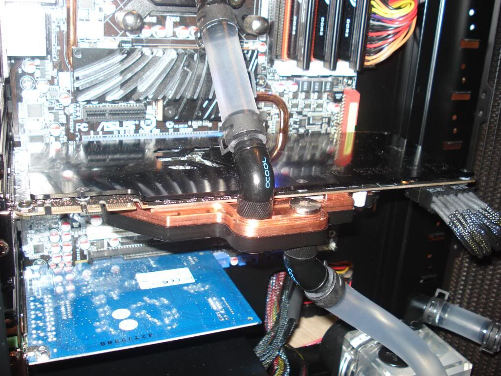

Look my rig on 1/2 http://i1208.photobucket.com/albums/cc373/ibanez1andrew/DSC06633-1.jpg
and then look at my sig.. which is using 7/16 .. so much cleaner.
