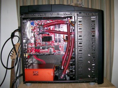

Ok i'm only thinking about it at this time and there is a high chance that if i wanna do any decent watercooling i'm gonna have to change case but i wanna know if anyone can think of how or where to slap a red on the case.
If i'm gonna do it i wanna do it properly and go for the 120.3
The back is always an option like so:
http://www.christianlykke.net/Lasse/Computer/29-05-2007/CAM_1012_800x600.JPG
I think that would be a bit of hassle for my plugging stuff in though...
Would it be possible to mount it on the side of the case that hasn't got the window (right)??? Or be too heavy for the thin metal?

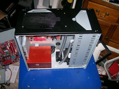

Mounting a 2x120 on the inside roof would work, if it was mounted on a shroud and spaced out from the roof, as a large part of the rad would be just blowing at sheet metal. If all of the output air from the rad could be channeled to the 200mm fan, then it would probably work. Along with two 120mm fans. it totals up to some serious ventilation. Yes, I would also use a shroud to space the 120s from the rad. Excellent and helpful answers, thanks.
I was thinking of leaving the fan on, and using a shroud to channel output air from the rad out the 200mm, for even more effective heat dissipation. That way, I can have two 120s blowing in to it, and a 200mm sucking away the heated air. The shroud will act as a spacer so that the rad is spaced away from the sheet metal that about 1/3 of it would normally be flush with. I'll attempt a photo mock-up later, is it isn't clear.
Kempez was right.. My question is where are the fans that are blowing through the radiator out through the 200mm fan? There wouldn't be enough room for shrouded 120mm fans below it would there?
As for the pic in my first post.. Does anyone know how I could get hold of those bracket / spacer type things?
name='Kempez' said:
I'd say the case acts as a shroud and he's mounted a 200mm fan on the top
Ok are there two different ideas going on here?
1. Having the 200mm fan on top of the rad sucking out of the case as it normally does... That isn't going to cool the rad which would then need fans attached to the bottom blowing out which there isn't room for.
2. Having the 200mm fan on top of the rad blowing in to the case (don't even know if able to be flipped) in which case is a ridiculously bad idea as the hot air would be going into the case and part of the rad wouldn't be directly cooled.
