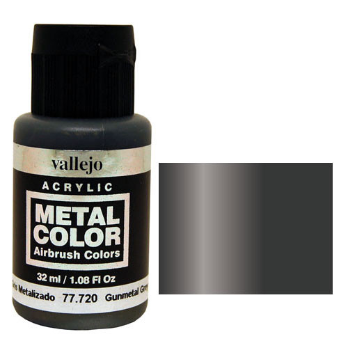

Accents are what make things pop. Red accents will be good. Red interior not so much. Call me boring Norman, but I am a big fan of grey. Dark/gunmetal/metallic etc.
This is a big favourite of mine.
VAL77720.jpg7
Well I was only worried about over doing it. That said, I don't think any one could really over do black. Not that I've ever seen any one try, but yeah I don't think it's possible /paintitblack.
Also note the res is clear as is the coolant now (that's a way old pic the pastel failed so I put in clear) and I will be using (probably) clear hosing and possibly a couple of hard runs to stop that big ole nasty return line that always bugs me with hoses. I'll curve it where it wants to curve, then go straight where it will look better straight.
Oh also, now that I can see your image... I want hammered finish dude. I also want to use Hammerite, as it's direct to metal, sticks like crap to a shovel and is very strong and hard wearing. If I go with a smooth finish and paint it by hand? yeah, brush mark heaven. Hammerite goes on, then reacts to hammered finish and all of the brush marks vanish. Not spray painting in my flat any more, I did a few bike parts a few weeks back and I am still cleaning off overspray from my floor (where it settled and then fell).
I can't spray paint here. Plus again, I've not seen a case with a hammered look interior before (with lots of matt acrylic either).
