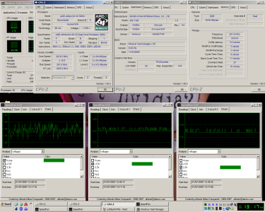

Enermax Infinity (650w 2nd Rig)
get.php
Enermax Infinity 720w (In my Gaming Rig)
get.php
Both taken after an Hour
I Have Ruled Out the possibility of Hard Disk problems (by buying a NEW one) and Clean Install of Windows with Only ONE SATA no Sound card, TV or WiFi.
Even with the Latest drivers it Still Falls over :cussing: Anyone else think it Could be something else other than PSU? last time i had to RMA a PSU it cost £20 (about 5 years ago)
Any more info needed? Added a Couple of attachments (The screenshot jus before it shut down & Everest System Summary)

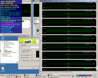

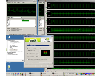

I noticed while running 2x GPU' (ALL Stock settings) Rivatuner repots the Core Voltage on GPU Dropping from 425Mhz to 351Mhz, This happens while running One in non-SLI mode too (ATM i am running)
  1. Leadtek 6800GS
  2. Samsung SP2504C
  3. Sony DVD/RW
  4. 2x Corsair512Mb
nrage I Really don't think its a Sound issue but i'll look into your other ideas also the drivers i'm using Worked prior.
I'll try the PSU From my Game rig which i didn't want to mess with :rolleyes:
see how that goes.

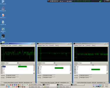

Finally Got round to puttin the old PSU OCZ520w on and after approx 45mins attachment untitled11.PNG
  1. Leadtek 6800GS
  2. Samsung SP2504C
  3. Sony DVD/RW
  4. 2x Corsair512Mb
Roughly the same time period as before untitled5.PNG with the Enermax
Also been listening to my mp3's NO Stuttering, gotta see Specialtech about RMA now :(
