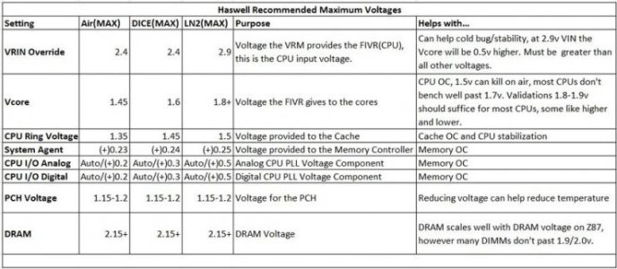

I also found the attached reference sheet for Haswell parameters, but it's up to you how much faith you put in it - it came from a forum somewhere and I have no idea how reliable the fact/opinion balance is!
I hope that helps :)
