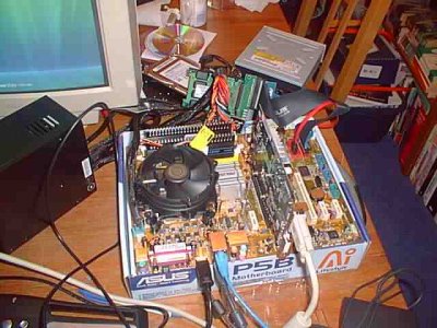

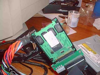

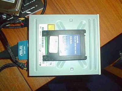

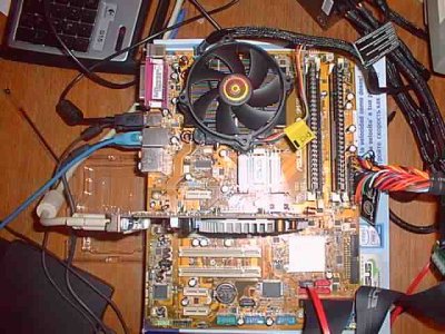

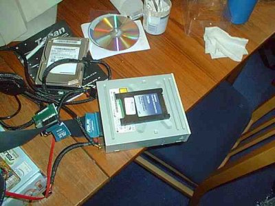

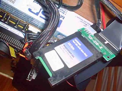

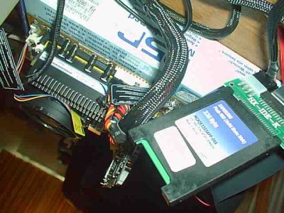

These are just an initial test of a single timing run.
System Spec: C2D X6800 in a Asus P5B with 2GB 6400 Ram. Standard HD is a 500GB Samsung Spinpoint
Time to boot through POST and other rubbish = 28 seconds
Time to boot Vista to CRTL-ALT-DEL prompt on Spinpoint = 58 seconds.
Vista Boot = 30 seconds
I now built Vista onto the Flash Drive using the same CD and same autounattend.xml file. loaded the current patches and attched to the domain so it should have been identical to the Hard Disk build.
Time to CTRL-ALT-DEL was 48 seconds. Vista Boot = 20 seconds
33% quicker would be my initial verdict...
Regards,
Sean
