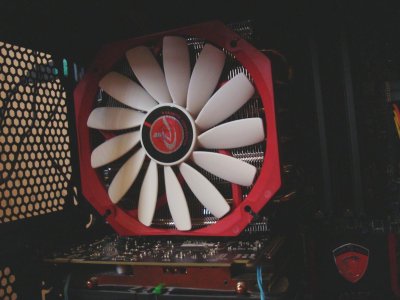

It can be mounted any which way if you've room... turns out I hadn't, so it would only go in with the heatpipe "elbows" on the RAM side. And I had to take two case fans out and fold my 4+4 CPU power out of the way even to get that far. This better be worth it...

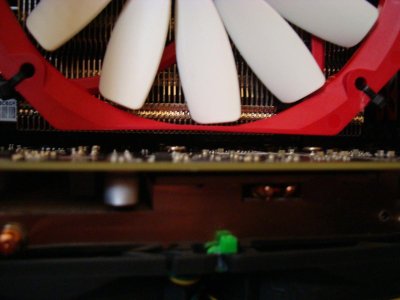

Post-finally, the fan... muppet strikes again. Getting the second clip in place takes the finger strength of a rock-climbing jazz pianist. And then, to my horror, I find out the bottom clip is fouling on the back of my graphics card! Sod it; I left the top clip in place and cable-tied the bottom of the fan to the heatsink.

At last, some good news! At idle my motherboard spins the fan at a measley 400-420 rpm, and I cannot hear it. As in stopping it makes no difference to the noise. None of that distinctive "crunchy" grind of a sleeve bearing except during spin up (and that's only going to happen once per sesson, and I won't have my ear to it by then).
OK... case side on, and let's show it some OCCT. Left it running for half an hour and the fan got up to a whopping 620 rpm. Still couldn't hear it. Bearing in mind I've just lost two case fans to this thing, the maximum for any core was 55 C. Yes, my Haswell has been undervolted to 0.92 V, but the Intel cooler was going just over 70 C under the same conditions and making a racket. My silence demon is sated
