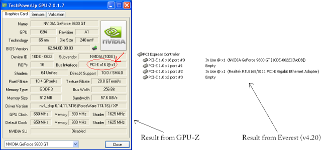

I'm having a problem with my PCI-E link been at 8x or lower when its a full 16x board supposedly (not SLI) :(
Its a Palit 9600GT 512mb with a Core/Shader/Mem of 650/1625/950(1900 effective).
My pci-e link speed sometimes fluctuates too, not while i'm using it, but after a reboot or two it changes.
It might be all well and good at 16x at some time, then it will drop to 8x and a popular one at the moment is 1x.
Obviously the performace difference between 8x and 16x is negligible if at all noticeable even on these more recent cards.
However, 1x as you can imagine is crippling, my framerates literally drop to under 50%.

The only thing that did give me the slightest bit of hope was when I used the friends rig to test the card, in which case the PC booted perfectly, and the link speed remained at 16x after several re-boots.
The PSU wierdly enough is the same as the one I have in my machine, rated at 550W and 30amps on the 12v rail to name a couple of specs.
So i'm thinking after all this that the most likely cause is a dodgy motherboard, at least dodgy in a compatibility-sense with the whole PCI-E 2.0 thing.
I was reading the specs of the PCI-Express 2.0 standard, and it seems that it supports a new features known as 'dynamic link scaling', intelligently adjusting the bus width depending on work load I guess.
However I'm not sure whether this will even take effect without a PCI-Express 2.0 motherboard, or with current drivers/BIOS revisions etc.
But could this be the graphics card not negotiating with the system bus properly and then giving the dodgy bleeps and knocking the link speed down to 8x or 1x?

No it should be x16 @ x16 not x1. GPU-Z shows the current link speed.
I will attach another GPU-Z pic here to show that:
Like I put above, sometimes it starts running at x8, sometimes x1 at random after a reboot.

Hehe, its just showing the same result as GPU-Z to rule out any software bugs.
God knows what the info means after the link speeds though.
